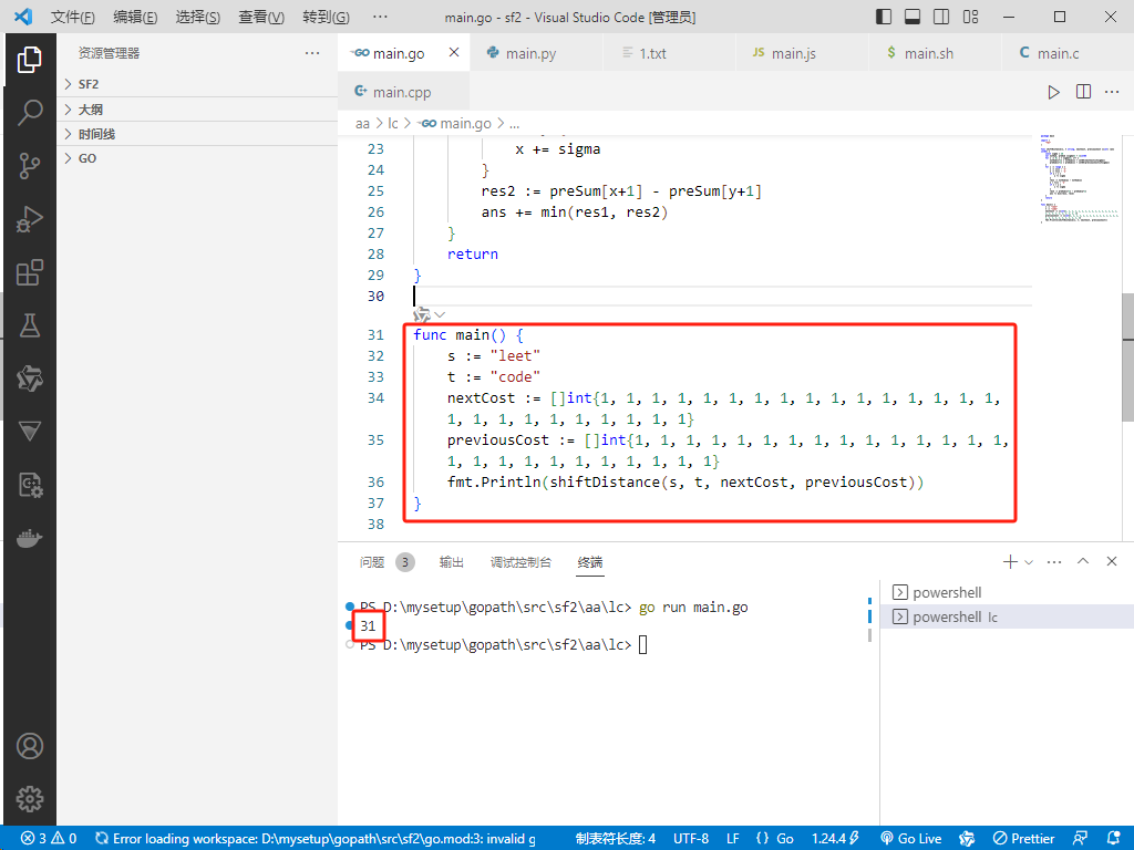

Go完整代码如下:
package main
import (
	"fmt"
func shiftDistance(s, t string, nextCost, previousCost []int) (ans int64) {
	const sigma = 26
	var nxtSum, preSum [sigma*2 + 1]int64
	for i := 0; i < sigma*2; i++ {
		nxtSum[i+1] = nxtSum[i] + int64(nextCost[i%sigma])
		preSum[i+1] = preSum[i] + int64(previousCost[i%sigma])
	for i := range s {
		x := s[i] - 'a'
		y := t[i] - 'a'
		if y < x {
			y += sigma
		res1 := nxtSum[y] - nxtSum[x]
		y = t[i] - 'a'
		if x < y {
			x += sigma
		res2 := preSum[x+1] - preSum[y+1]
		ans += min(res1, res2)
	return
func main() {
	s := "leet"
	t := "code"
	nextCost := []int{1, 1, 1, 1, 1, 1, 1, 1, 1, 1, 1, 1, 1, 1, 1, 1, 1, 1, 1, 1, 1, 1, 1, 1, 1, 1}
	previousCost := []int{1, 1, 1, 1, 1, 1, 1, 1, 1, 1, 1, 1, 1, 1, 1, 1, 1, 1, 1, 1, 1, 1, 1, 1, 1, 1}
	fmt.Println(shiftDistance(s, t, nextCost, previousCost))

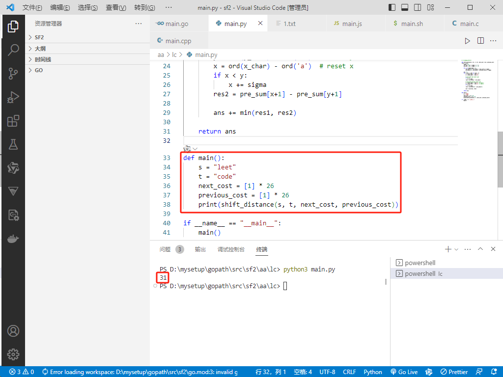

Python完整代码如下:
# -*-coding:utf-8-*-
def shift_distance(s: str, t: str, next_cost: list, previous_cost: list) -> int:
    sigma = 26
    nxt_sum = [0] * (sigma * 2 + 1)
    pre_sum = [0] * (sigma * 2 + 1)
    for i in range(sigma * 2):
        nxt_sum[i+1] = nxt_sum[i] + next_cost[i % sigma]
        pre_sum[i+1] = pre_sum[i] + previous_cost[i % sigma]
    ans = 0
    for x_char, y_char in zip(s, t):
        x = ord(x_char) - ord('a')
        y = ord(y_char) - ord('a')
        # Calculate next shift cost
        if y < x:
            y += sigma
        res1 = nxt_sum[y] - nxt_sum[x]
        # Calculate previous shift cost
        y = ord(y_char) - ord('a')  # reset y
        x = ord(x_char) - ord('a')  # reset x
        if x < y:
            x += sigma
        res2 = pre_sum[x+1] - pre_sum[y+1]
    return ans
def main():
    s = "leet"
    t = "code"
    next_cost = [1] * 26
    previous_cost = [1] * 26
    print(shift_distance(s, t, next_cost, previous_cost))
if __name__ == "__main__":
    main()
