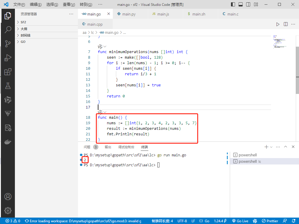

Go完整代码如下:
package main
import (
	"fmt"
func minimumOperations(nums []int) int {
	seen := make([]bool, 128)
	for i := len(nums) - 1; i >= 0; i-- {
		if seen[nums[i]] {
			return i/3 + 1
		seen[nums[i]] = true
	return 0
func main() {
	nums := []int{1, 2, 3, 4, 2, 3, 3, 5, 7}
	result := minimumOperations(nums)
	fmt.Println(result)

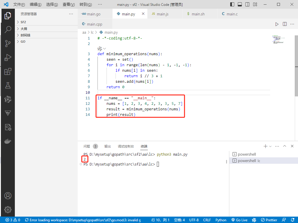

Python完整代码如下:
# -*-coding:utf-8-*-
def minimum_operations(nums):
    seen = set()
    for i in range(len(nums) - 1, -1, -1):
        if nums[i] in seen:
            return i // 3 + 1
        seen.add(nums[i])
    return 0
if __name__ == "__main__":
    nums = [1, 2, 3, 4, 2, 3, 3, 5, 7]
    result = minimum_operations(nums)
    print(result)
