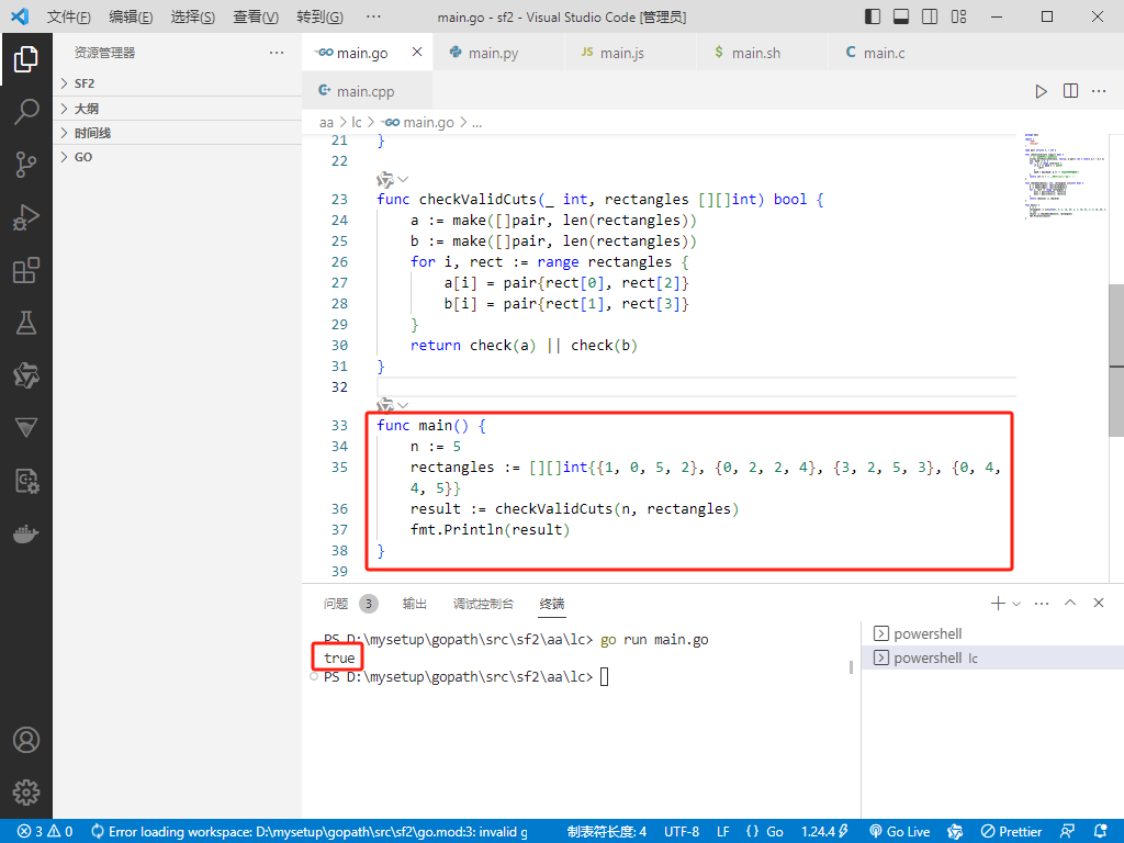

Go完整代码如下:
package main
import (
"fmt"
"slices"
type pair struct{ l, r int }
func check(intervals []pair) bool {
// 按照左端点从小到大排序
slices.SortFunc(intervals, func(a, b pair) int { return a.l - b.l })
cnt, maxR := 0, 0
for _, p := range intervals {
if p.l >= maxR { // 新区间
cnt++
maxR = max(maxR, p.r) // 更新右端点最大值
return cnt >= 3 // 也可以在循环中提前退出
func checkValidCuts(_ int, rectangles [][]int) bool {
a := make([]pair, len(rectangles))
b := make([]pair, len(rectangles))
for i, rect := range rectangles {
a[i] = pair{rect[0], rect[2]}
b[i] = pair{rect[1], rect[3]}
return check(a) || check(b)
func main() {
n := 5
rectangles := [][]int{{1, 0, 5, 2}, {0, 2, 2, 4}, {3, 2, 5, 3}, {0, 4, 4, 5}}
result := checkValidCuts(n, rectangles)
fmt.Println(result)

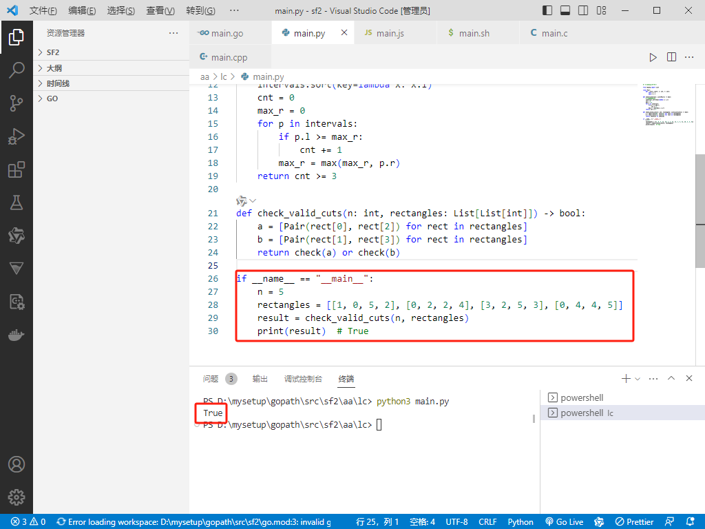

Python完整代码如下:
# -*-coding:utf-8-*-
from typing import List
class Pair:
def __init__(self, l: int, r: int):
self.l = l
self.r = r
def check(intervals: List[Pair]) -> bool:
# 按左端点排序
intervals.sort(key=lambda x: x.l)
cnt = 0
max_r = 0
for p in intervals:
if p.l >= max_r:
cnt += 1
max_r = max(max_r, p.r)
return cnt >= 3
def check_valid_cuts(n: int, rectangles: List[List[int]]) -> bool:
a = [Pair(rect[0], rect[2]) for rect in rectangles]
b = [Pair(rect[1], rect[3]) for rect in rectangles]
return check(a) or check(b)
if __name__ == "__main__":
n = 5
rectangles = [[1, 0, 5, 2], [0, 2, 2, 4], [3, 2, 5, 3], [0, 4, 4, 5]]
result = check_valid_cuts(n, rectangles)
print(result) # True
