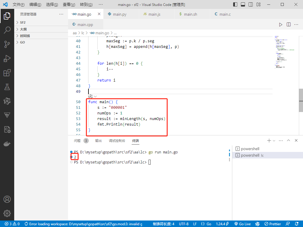

Go完整代码如下:
package main
import (
	"fmt"
func minLength(s string, numOps int) int {
	n := len(s)
	cnt := 0
	for i, b := range s {
		cnt += (int(b) ^ i) & 1
	if min(cnt, n-cnt) <= numOps {
		return 1
	type pair struct{ k, seg int }
	h := make([][]pair, n+1)
	k := 0
	for i := 0; i < n; i++ {
		k++
		// 到达连续相同子串的末尾
		if i == n-1 || s[i] != s[i+1] {
			h[k] = append(h[k], pair{k, 1}) // 原始子串长度,段数
			k = 0
	i := n
	for range numOps {
		for len(h[i]) == 0 {
			i--
		if i == 2 {
			return 2
		p := h[i][len(h[i])-1]
		h[i] = h[i][:len(h[i])-1]
		p.seg++
		maxSeg := p.k / p.seg
		h[maxSeg] = append(h[maxSeg], p)
		i--
	return i
func main() {
	s := "000001"
	numOps := 1
	result := minLength(s, numOps)
	fmt.Println(result)

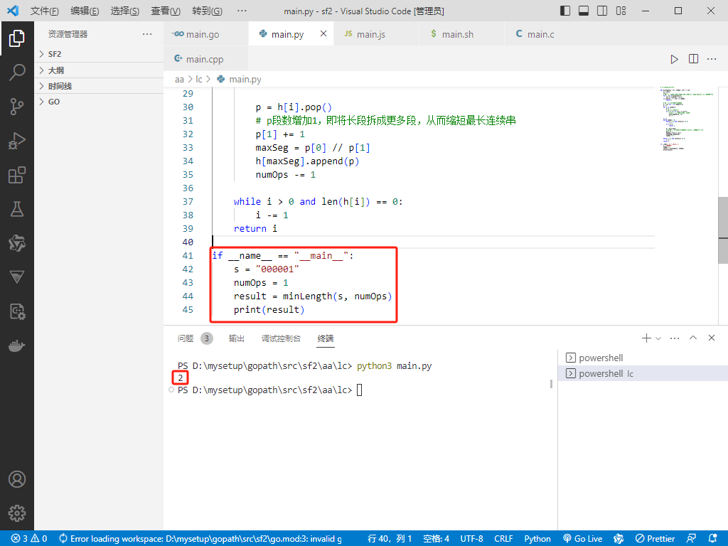

Python完整代码如下:
# -*-coding:utf-8-*-
def minLength(s: str, numOps: int) -> int:
    n = len(s)
    cnt = 0
    # 统计 s 中奇偶位置与字符的 XOR 个数,用于判断是否能通过翻转变成交替串
    for i, ch in enumerate(s):
        cnt += (ord(ch) ^ i) & 1
    if min(cnt, n - cnt) <= numOps:
        return 1
    # 构造连续相同子串长度数组
    h = [[] for _ in range(n+1)]
    k = 0
    for i in range(n):
        k += 1
        # 到达连续子串结尾
        if i == n-1 or s[i] != s[i+1]:
            # pair: (原始子串长度k, 段数1)
            h[k].append([k, 1])
            k = 0
    i = n
    while numOps > 0:
        while i > 0 and len(h[i]) == 0:
            i -= 1
        if i == 2:
            return 2
        p = h[i].pop()
        # p段数增加1,即将长段拆成更多段,从而缩短最长连续串
        p[1] += 1
        maxSeg = p[0] // p[1]
        h[maxSeg].append(p)
        numOps -= 1
        i -= 1
    return i
if __name__ == "__main__":
    s = "000001"
    numOps = 1
    result = minLength(s, numOps)
    print(result)
