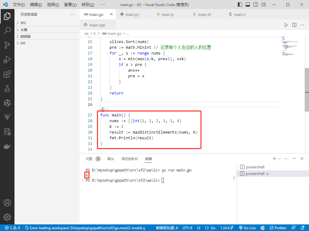

Go完整代码如下:
package main
import (
	"fmt"
	"math"
	"slices"
func maxDistinctElements(nums []int, k int) (ans int) {
	n := len(nums)
	if k*2+1 >= n {
		return n
	slices.Sort(nums)
	pre := math.MinInt // 记录每个人左边的人的位置
	for _, x := range nums {
		x = min(max(x-k, pre+1), x+k)
		if x > pre {
			ans++
			pre = x
	return
func main() {
	nums := []int{1, 2, 2, 3, 3, 4}
	k := 2
	result := maxDistinctElements(nums, k)
	fmt.Println(result)

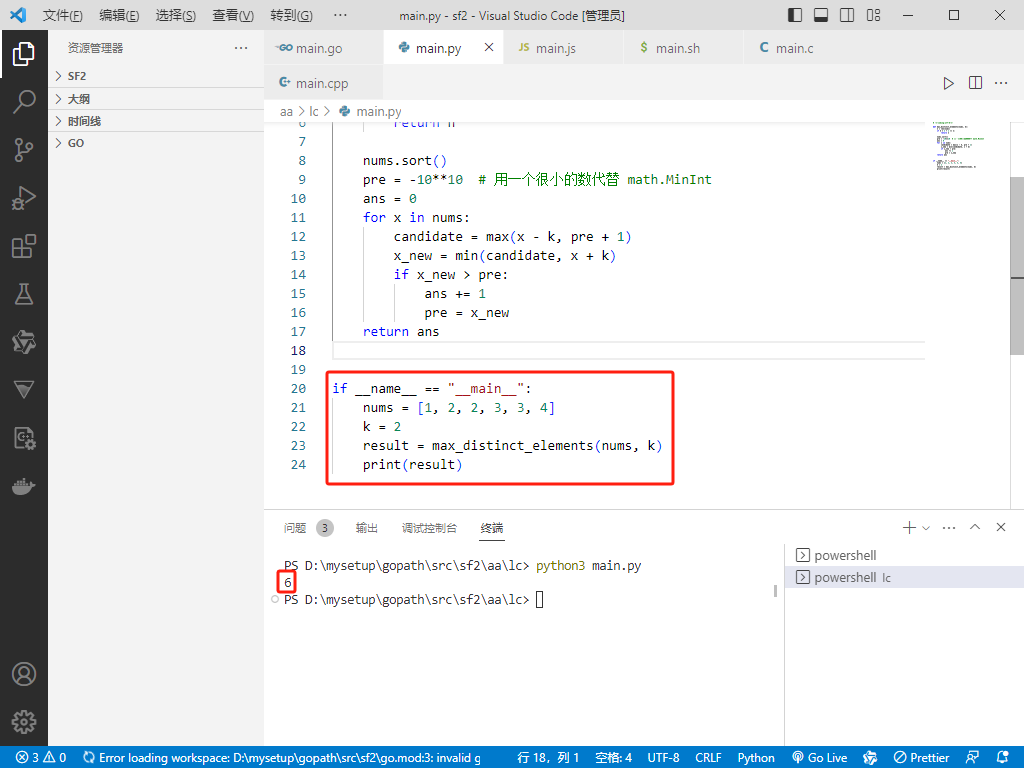

Python完整代码如下:
# -*-coding:utf-8-*-
def max_distinct_elements(nums, k):
    n = len(nums)
    if k * 2 + 1 >= n:
        return n
    nums.sort()
    pre = -10**10  # 用一个很小的数代替 math.MinInt
    ans = 0
    for x in nums:
        candidate = max(x - k, pre + 1)
        x_new = min(candidate, x + k)
        if x_new > pre:
            ans += 1
            pre = x_new
    return ans
if __name__ == "__main__":
    nums = [1, 2, 2, 3, 3, 4]
    k = 2
    result = max_distinct_elements(nums, k)
    print(result)
