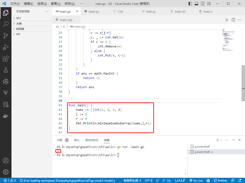

func main() {
	nums := []int{1, 2, 3, 4}
	l := 2
	r := 4
	fmt.Println(minimumSumSubarray(nums,l,r))
