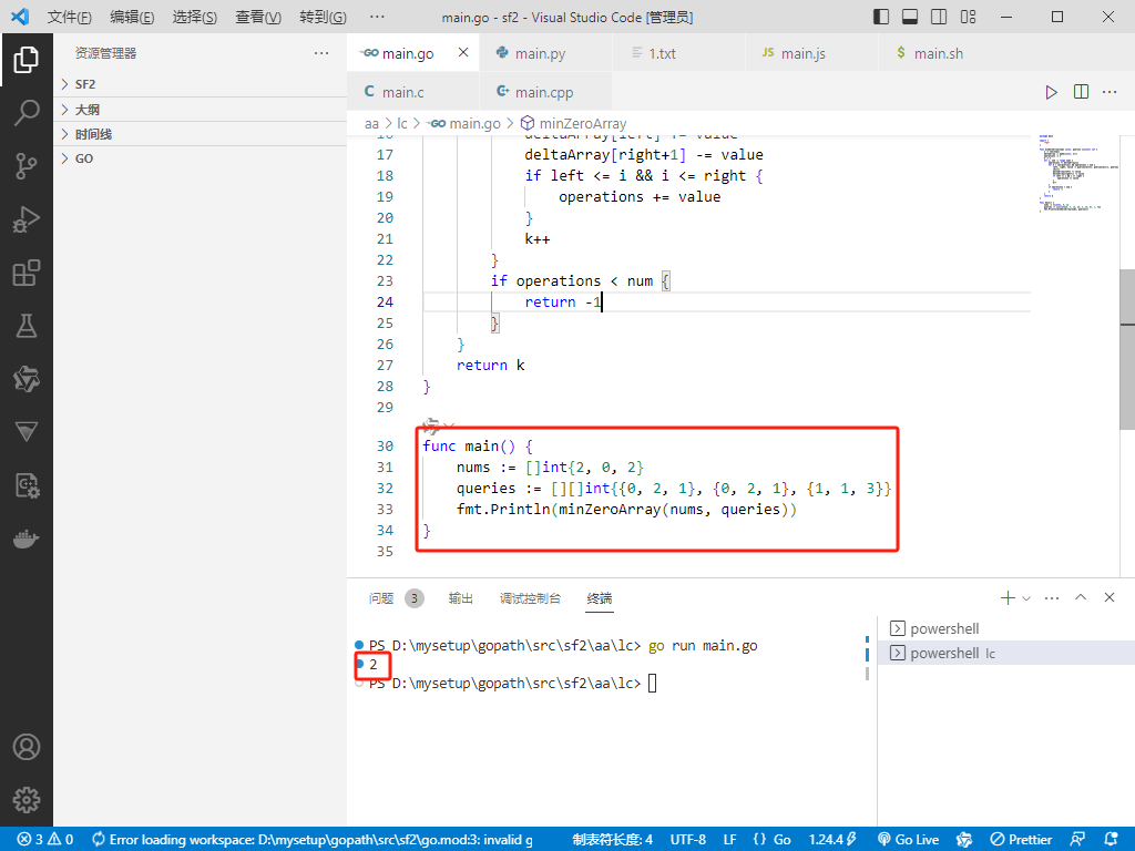

Go完整代码如下:
package main
import (
	"fmt"
func minZeroArray(nums []int, queries [][]int) int {
	n := len(nums)
	deltaArray := make([]int, n+1)
	operations := 0
	k := 0
	for i, num := range nums {
		operations += deltaArray[i]
		for k < len(queries) && operations < num {
			left, right, value := queries[k][0], queries[k][1], queries[k][2]
			deltaArray[left] += value
			deltaArray[right+1] -= value
			if left <= i && i <= right {
				operations += value
			k++
		if operations < num {
			return -1
	return k
func main() {
	nums := []int{2, 0, 2}
	queries := [][]int{{0, 2, 1}, {0, 2, 1}, {1, 1, 3}}
	fmt.Println(minZeroArray(nums, queries))

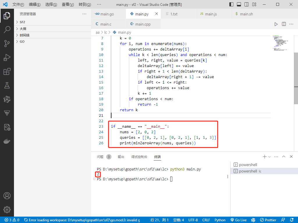

Python完整代码如下:
# -*-coding:utf-8-*-
def minZeroArray(nums, queries):
    n = len(nums)
    deltaArray = [0] * (n + 1)
    operations = 0
    k = 0
    for i, num in enumerate(nums):
        while k < len(queries) and operations < num:
            left, right, value = queries[k]
            if right + 1 < len(deltaArray):
                deltaArray[right + 1] -= value
            if left <= i <= right:
                operations += value
            k += 1
        if operations < num:
            return -1
    return k
if __name__ == "__main__":
    nums = [2, 0, 2]
    queries = [[0, 2, 1], [0, 2, 1], [1, 1, 3]]
    print(minZeroArray(nums, queries))
