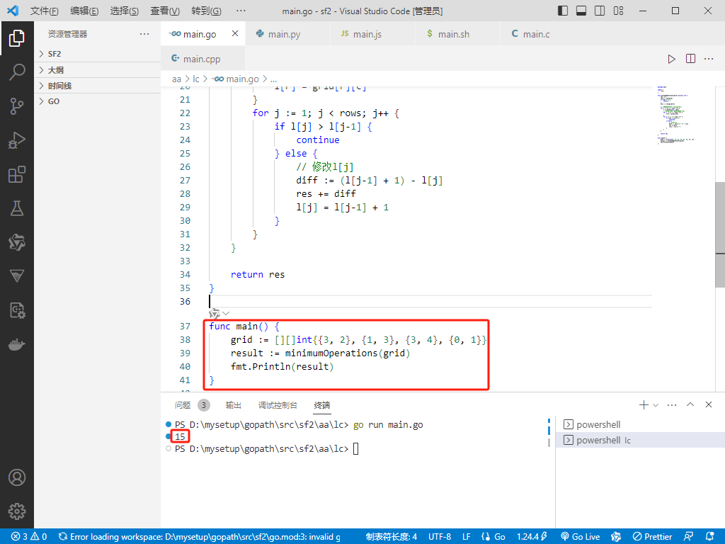

Go完整代码如下:
package main
import (
	"fmt"
func minimumOperations(grid [][]int) int {
	res := 0
	rows := len(grid)
	if rows == 0 {
		return 0
	cols := len(grid[0])
	// 按列处理(模拟 zip(*grid))
	for c := 0; c < cols; c++ {
		l := make([]int, rows)
		// 先把grid这一列的元素赋值给l
		for r := 0; r < rows; r++ {
			l[r] = grid[r][c]
		for j := 1; j < rows; j++ {
			if l[j] > l[j-1] {
				continue
			} else {
				// 修改l[j]
				diff := (l[j-1] + 1) - l[j]
				res += diff
				l[j] = l[j-1] + 1
	return res
func main() {
	grid := [][]int{{3, 2}, {1, 3}, {3, 4}, {0, 1}}
	result := minimumOperations(grid)
	fmt.Println(result)
