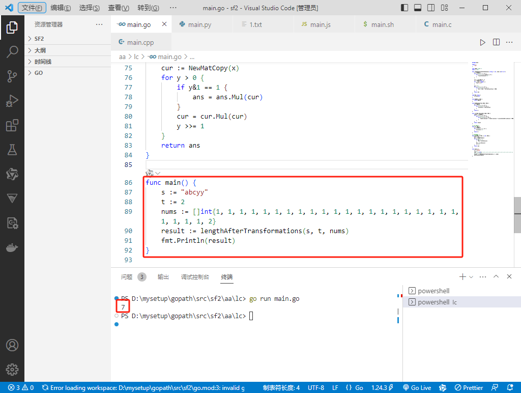

Go完整代码如下:
package main
import (
	"fmt"
const MOD = 1e9 + 7
const L = 26
func lengthAfterTransformations(s string, t int, nums []int) int {
	T := NewMat()
	for i := 0; i < L; i++ {
		for j := 1; j <= nums[i]; j++ {
			T.a[(i+j)%L][i] = 1
	res := quickMul(T, t)
	f := make([]int, L)
	for _, ch := range s {
		f[ch-'a']++
	ans := 0
		for j := 0; j < L; j++ {
			ans = (ans + res.a[i][j]*f[j]) % MOD
	return ans
type Mat struct {
	a [L][L]int
func NewMat() *Mat {
	return &Mat{}
func NewMatCopy(from *Mat) *Mat {
	m := &Mat{}
			m.a[i][j] = from.a[i][j]
	return m
func (m *Mat) Mul(other *Mat) *Mat {
	result := NewMat()
			for k := 0; k < L; k++ {
				result.a[i][j] = (result.a[i][j] + m.a[i][k]*other.a[k][j]) % MOD
	return result
/* 单位矩阵 */
func I() *Mat {
	m := NewMat()
		m.a[i][i] = 1
	return m
/* 矩阵快速幂 */
func quickMul(x *Mat, y int) *Mat {
	ans := I()
	cur := NewMatCopy(x)
	for y > 0 {
		if y&1 == 1 {
			ans = ans.Mul(cur)
		cur = cur.Mul(cur)
		y >>= 1
	return ans
func main() {
	s := "abcyy"
	t := 2
	nums := []int{1, 1, 1, 1, 1, 1, 1, 1, 1, 1, 1, 1, 1, 1, 1, 1, 1, 1, 1, 1, 1, 1, 1, 1, 1, 2}
	result := lengthAfterTransformations(s, t, nums)
	fmt.Println(result)

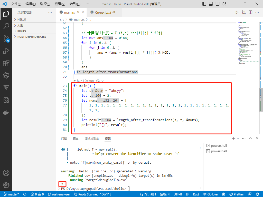

Rust完整代码如下:
const MOD: i64 = 1_000_000_007;
const L: usize = 26;
type Mat = [[i64; L]; L];
fn new_mat() -> Mat {
    [[0; L]; L]
fn identity() -> Mat {
    let mut m = new_mat();
    for i in 0..L {
        m[i][i] = 1;
    m
fn mat_mul(a: &Mat, b: &Mat) -> Mat {
    let mut res = new_mat();
    for i in 0..L {
        for j in 0..L {
            let mut sum = 0;
            for k in 0..L {
                sum += a[i][k] * b[k][j];
            res[i][j] = sum % MOD;
    res
fn mat_pow(mut base: Mat, mut exp: i64) -> Mat {
    let mut result = identity();
    while exp > 0 {
        if exp & 1 == 1 {
            result = mat_mul(&result, &base);
        base = mat_mul(&base, &base);
        exp >>= 1;
    result
fn length_after_transformations(s: &str, t: i64, nums: &[i32]) -> i64 {
    // 构造转换矩阵 T,T[i][j] = 1 表示从 j 变成 i 的可能路径
    let mut T = new_mat();
    for i in 0..L {
        for j in 1..=nums[i] {
            let to = (i + j as usize) % L;
            T[to][i] = 1;
    // 矩阵快速幂计算 T^t
    let res = mat_pow(T, t);
    // 统计初始字符串中各字母的数量
    let mut f = [0i64; L];
    for b in s.bytes() {
        f[(b - b'a') as usize] += 1;
    // 计算最终长度 = ∑_(i,j) res[i][j] * f[j]
    let mut ans = 0i64;
    for i in 0..L {
        for j in 0..L {
            ans = (ans + res[i][j] * f[j]) % MOD;
    ans
fn main() {
    let s = "abcyy";
    let t = 2;
    let nums = [
        1, 1, 1, 1, 1, 1, 1, 1, 1, 1, 1, 1, 1, 1, 1, 1, 1, 1, 1, 1, 1, 1, 1, 1, 1, 2,
    let result = length_after_transformations(s, t, &nums);
    println!("{}", result);
