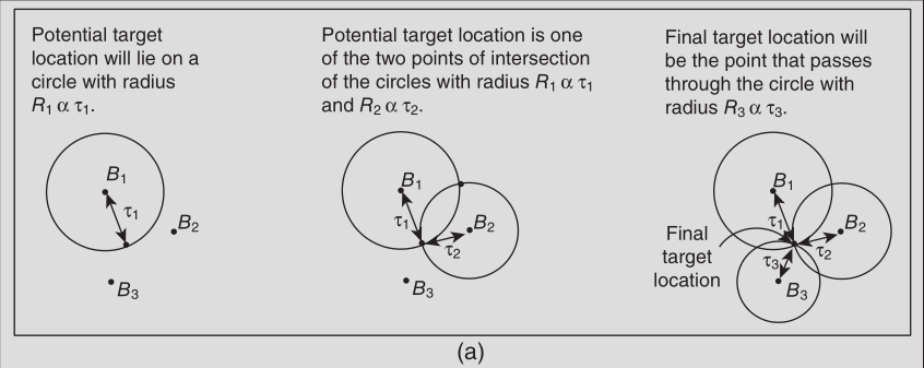

Assuming known positions of base nodes and a coplanar scenario, three base nodes and three measurements of distances (TOA) are required to localize a target node (see Fig. 1.2 a).
假设已知基节点位置且为共面场景,需要三个基本节点和三个距离测量(TOA)来定位目标节点(参见图1.2a)。
In a non - coplanar case, four base nodes are required.
非共面场景,需要四个基节点。
Using the measurement of distance, the position of a target node is localized within a sphere of radius
with the receiver i at the center of the sphere (where
is directly proportional to the TOA
as shown in Figure 1.2 a. The localization of the target node can be carried out either by base nodes using a master station or by the target node itself.
使用距离测量,目标节点的位置定位在半径
范围内,接收器i位于球体的中心(其中
与TOA
成正比,如图1.2a所示。目标节点的定位 可以由使用主站的基节点或由目标节点本身执行。(理解下这句话)
Figure 1.2 (a) Operation of TOA
