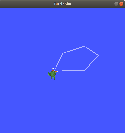

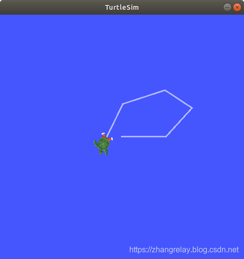

- turtlesim(也移植到了Dashing)
- turtlesim (also backported to Dashing)
