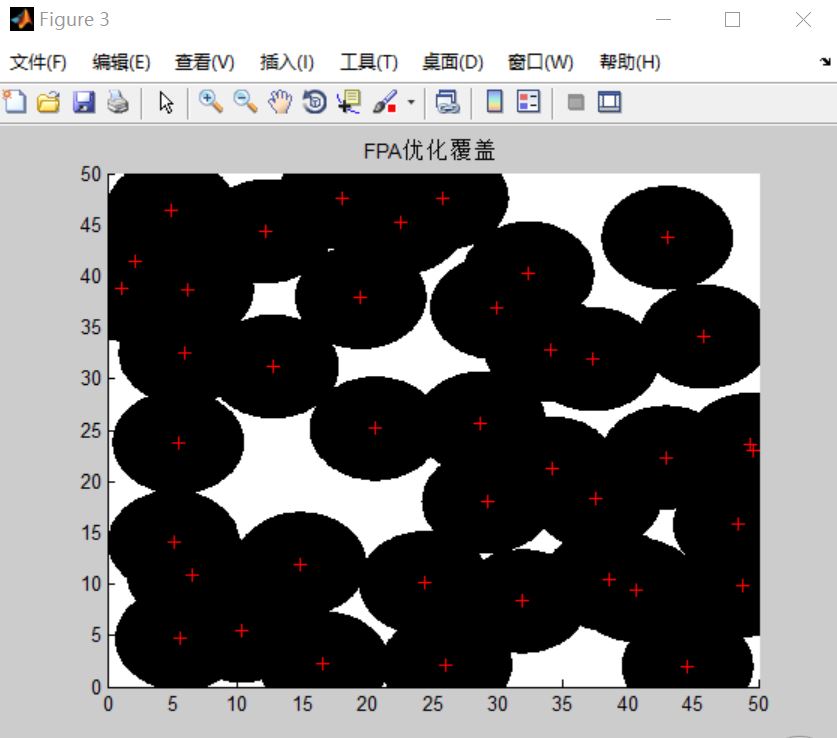

[bestvalue_FPA, gbest_FPA, Curve_FPA] = FPA(N, maxgen, Rs, Re, L, data, X, fitness, lb, ub, dim);
[bestvalue_IWO, gbest_IWO, Curve_IWO] = IWO(N, maxgen, Rs, Re, L, data, X, fitness, lb, ub, dim);
[bestvalue_IWOFPA, gbest_IWOFPA, Curve_IWOFPA] = IWOFPA(N, maxgen, Rs, Re, L, data, X, fitness, lb, ub, dim);

figure;
t = 1:maxgen;
plot(t, Curve_FPA, 'bo-', t, Curve_IWO, 'g*-', t, Curve_IWOFPA, 'r^-',...
    'linewidth', 2, 'linewidth', 1.5, 'MarkerSize',7, 'MarkerIndices', 1:30:maxgen);
legend('FPA', 'IWO', 'IWOFPA');
xlabel '迭代次数';
ylabel '覆盖率';

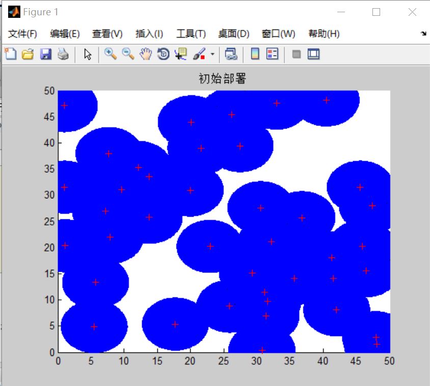

%% 初始结果显示
x = gbest(1:2:end);
y = gbest(2:2:end);
disp('初始位置:' );
for i = 1:dim/2
    disp([num2str(x(i)), '     ', num2str(y(i))]);
end
disp(['初始覆盖率:', num2str(fitnessgbest)]);
% 初始覆盖图
figure
for i = 1:dim/2
    axis([0 L 0 L]);            % 限制坐标范围
    sita = 0:pi/100:2*pi;   % 角度[0, 2*pi]
    hold on;
    fill(x(i)+Rs*cos(sita), y(i)+Rs*sin(sita), 'b');
    plot(x(i)+Rs*cos(sita), y(i)+Rs*sin(sita), 'b');
end
plot(x, y, 'r+');
title '初始部署';

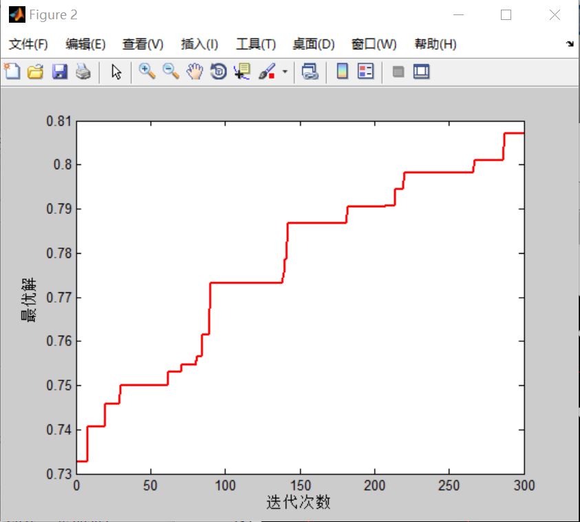

%% 绘图
figure;
plot(BestCosts, 'r', 'lineWidth', 2);          %  画出迭代图
title('算法训练过程', 'fontsize', 12);
xlabel('迭代次数', 'fontsize', 12);
ylabel('粒子覆盖率', 'fontsize', 12);
