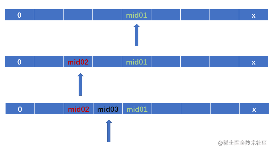

  • 二分法求解
这是在暴力求解算法的基础上进行演化,每次都取中间的值,在两端可以设立双指针,根据这两根指针来判断中间值。如果中间值乘积大于x,则将右指针修改为中间值-1,否则将res先赋值为中间值,并且左指针修改为中间值+1
二分代码:
var mySqrt = function(x) {
    if (x == 0 | x == 1) return x;
    let res = 0;
    let leftindex = 0, rightindex = x;
    while(leftindex <= rightindex) {
        let mid = parseInt(leftindex + (rightindex - leftindex)/2);
        if (mid * mid <= x) {
            res = mid;
            leftindex = mid + 1;
        } else {
            rightindex = mid - 1;
    return res;
