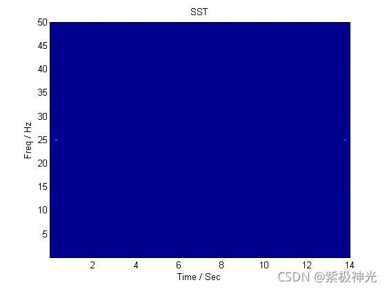

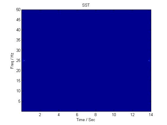

Ts  = SST(Sig',100);
figure
imagesc(time,fre,abs(Ts));
axis xy
ylabel('Freq / Hz');
xlabel('Time / Sec');
title('SST');

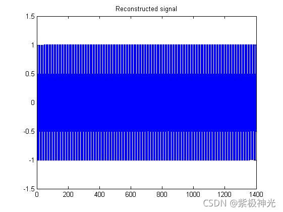

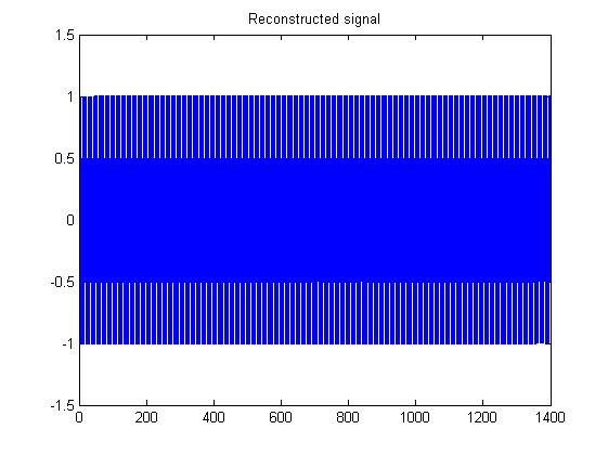

%signal reconstruction.
s=real(sum(Ts));
%Reconstructed signal.
figure
plot(s);
title('Reconstructed signal');

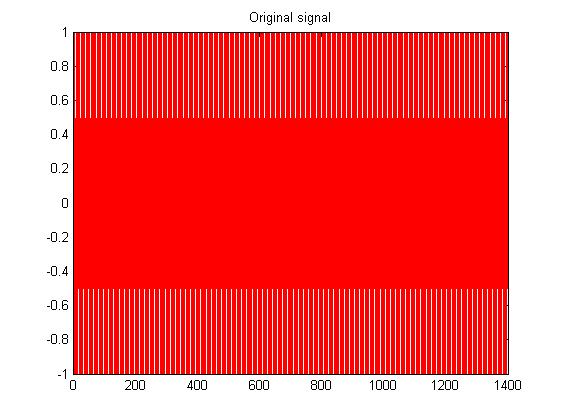

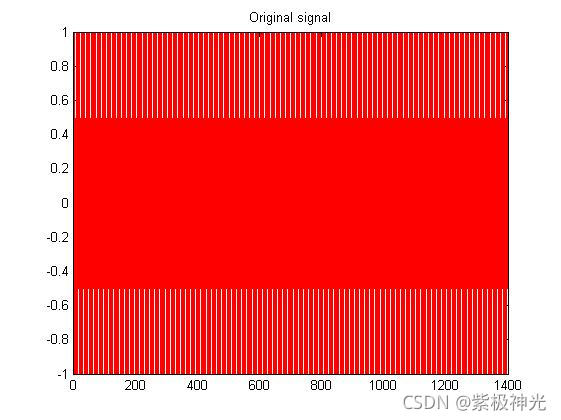

%Original signal
figure
plot(Sig,'r-');
title('Original signal');
