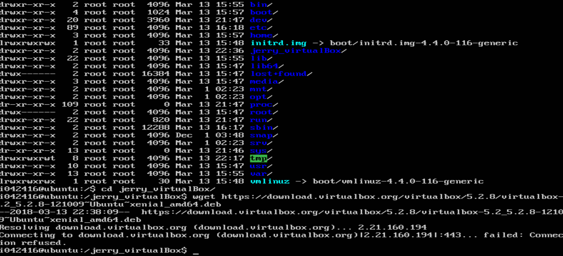

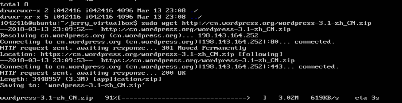

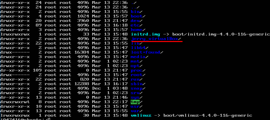

新建一个folder jerry_virtualbox:
使用wget下载virtualbox安装包:https://download.virtualbox.org/virtualbox/5.2.8/virtualbox-5.2_5.2.8-121009~Ubuntu~xenial_amd64.deb

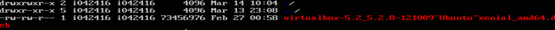

下载完毕:
使用sudo dpkg -i <package name>安装.

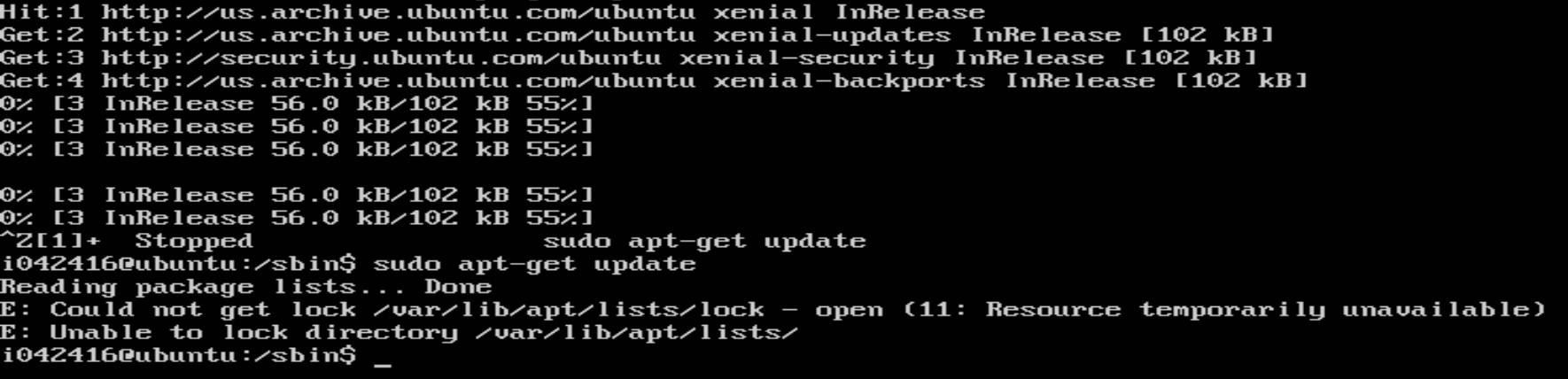

之后apt-get update. 如果遇到Could not get lock /var/lib/apt/lists/lock - open: Resource temporarily unavailable - unable to lock directory /var/lib/apt/lists的错误信息:
sudo rm -vf /var/lib/apt/lists/*

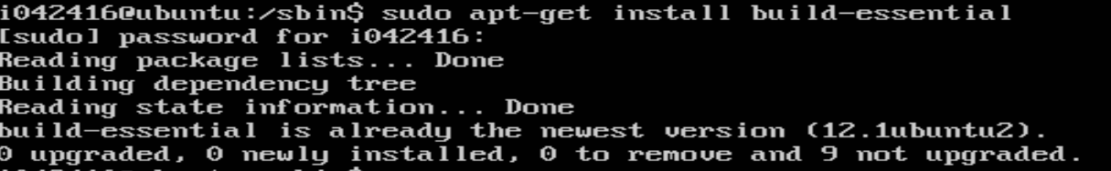

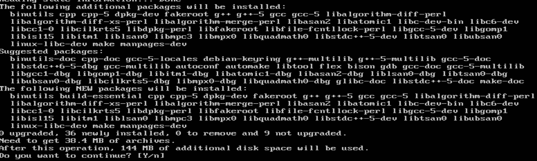

apt-get install build-essential

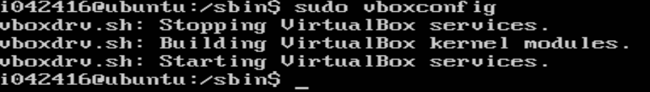

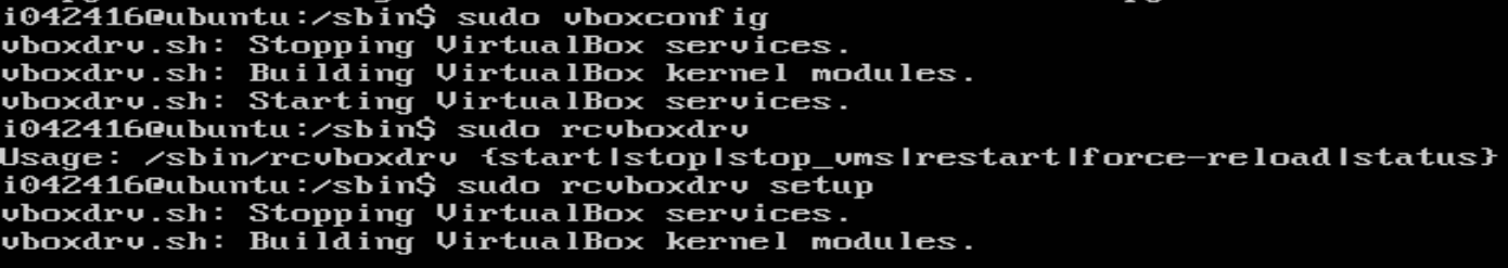

sudo vboxconfig

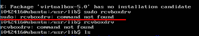

sudo rcvboxdrv setup:
安装完毕。
