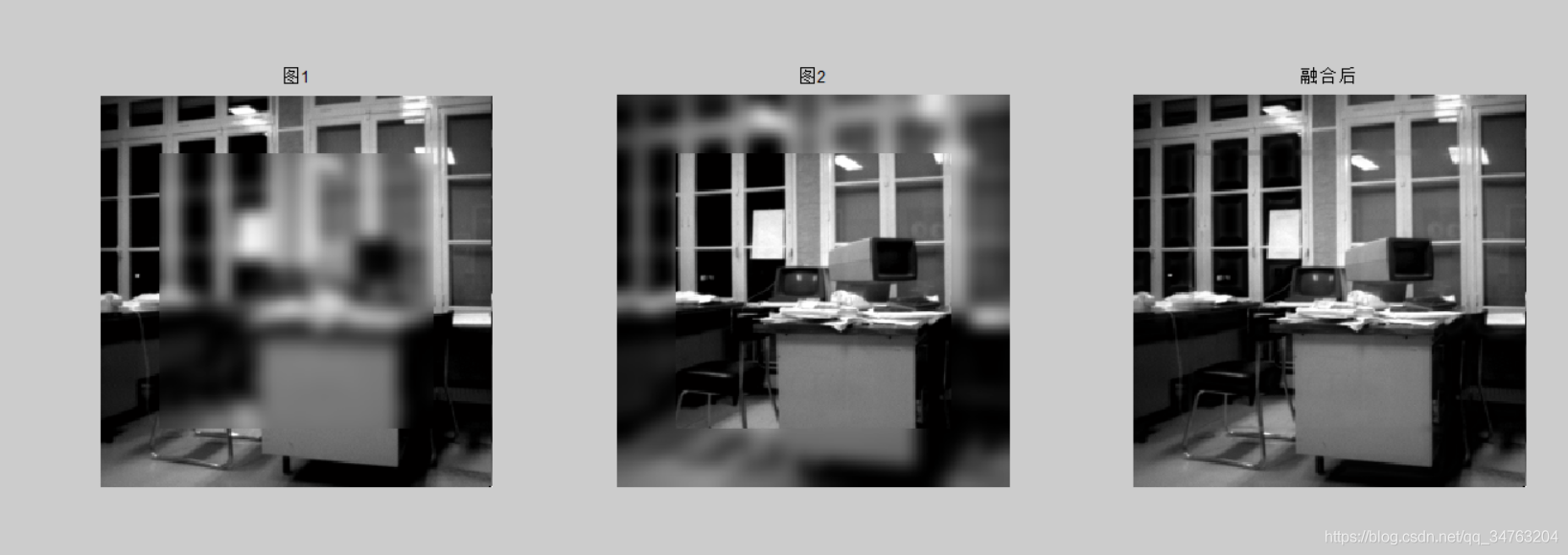

   figure,subplot(131);imshow(x{1});title('图1')
  subplot(132);imshow(x{2});title('图2')
  subplot(133),imshow(xfused8)  ;title('融合后')
end

三、运行结果
