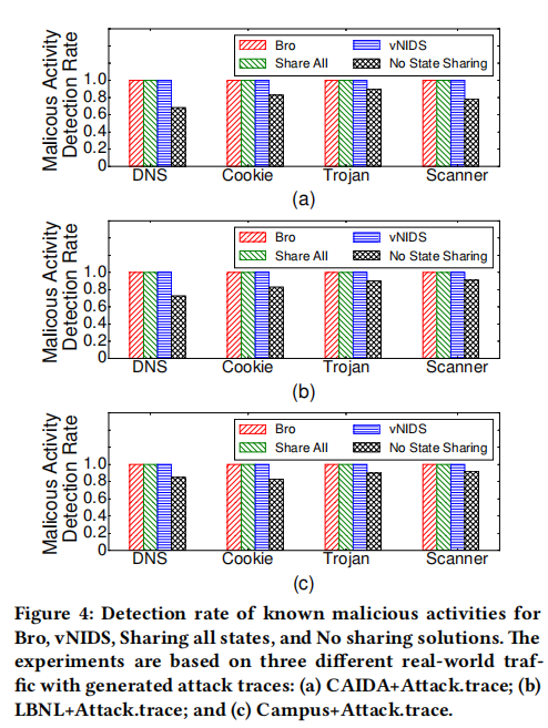

- Demonstrating the intrusion detection effectiveness of vNIDS. We run our virtualized NIDS and compare its detection results with those generated by Bro NIDS based on multiple real-world traffic traces (Figure 4).
 - Evaluating the performance overhead of detection state sharing among instances in different scenarios: 1) without detection state sharing; 2) sharing all detection states; and 3) only sharing global detection states. The results are shown in Figure 5. The statistics of global states, local states, and forward statements are shown in Table 2.
 - Demonstrating the flexibility of vNIDS regarding placement location. In particular, we quantify the communication overhead between virtualized NIDS instances across different data centers that are geographically distributed (Figure 8).
 - Hongda Li, et al. vNIDS: Towards Elastic Security with Safe and Efficient Virtualization of Network Intrusion Detection Systems. CCS.

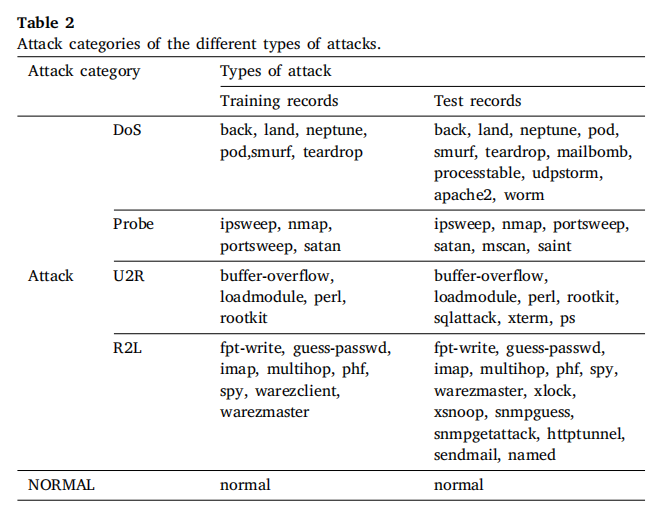

(3) Mohammed A. Ambusaidi, et al. Building an Intrusion Detection System Using a Filter-Based Feature Selection Algorithm. IEEE TRANSACTIONS ON COMPUTERS.
Currently, there are only a few public datasets available for intrusion detection evaluation. Among these datasets, the KDD Cup 99 dataset, NSL-KDD dataset and Kyoto 2006+ dataset have been commonly used in the literature to assess the performance of IDSes. According to the review by Tsai et al. [43], the majority of the IDS experiments were performed on the KDD Cup 99 datasets. In addition, these datasets have different data sizes and various numbers of features which provide comprehensive tests in validating feature selection methods. Therefore, in order to facilitate a fair and rational comparison with other state-of-the-art detection approaches, we have selected these three datasets to evaluate the performance of our detection system.
The KDD Cup 99 dataset is one of the most popular and comprehensive intrusion detection datasets and is widely applied to evaluate the performance of intrusion detection systems [43]. It consists of five different classes, which are normal and four types of attack (i.e., DoS, Probe, U2R and R2L). It contains training data with approximately five million connection records and test data with about two million connection records. Each record in these datasets is labeled as either normal or an attack, and it has 41 different quantitative and qualitative features.
The NSL-KDD is a new revised version of the KDD Cup 99 that has been proposed by Tavallaee et al. in [24]. This dataset addresses some problems included in the KDD Cup 99 dataset such as a huge number of redundant records in KDD Cup 99 data. As in the case of the KDD Cup 99 dataset, each record in the NSL-KDD dataset is composed of 41 different quantitative and qualitative features.

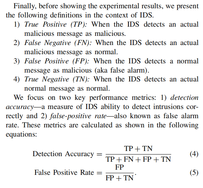

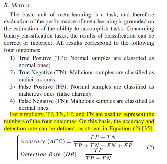

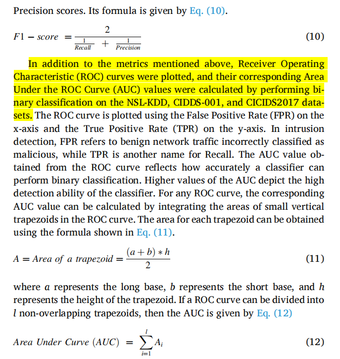

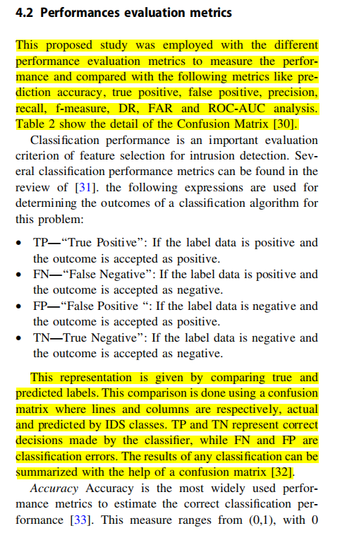

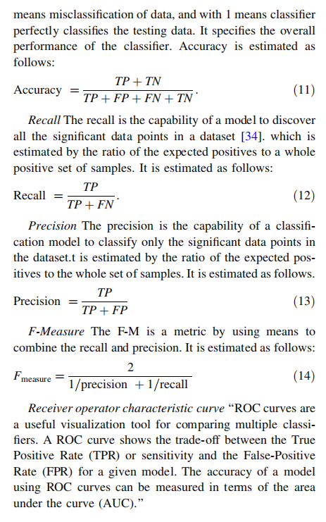

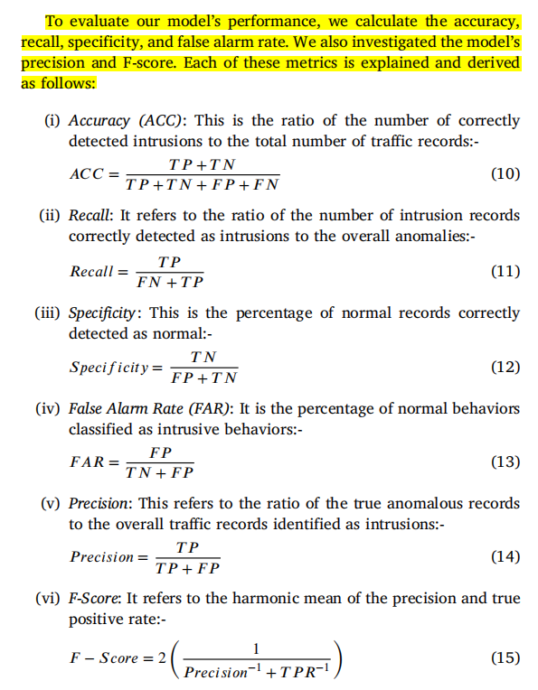

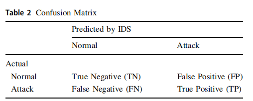

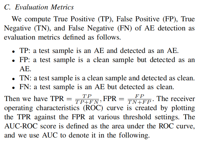

该部分介绍模型的评估指标,常见的包括准确率、召回率、精确率、F值、误报率等。
Chuanpu Fu, et al. Realtime Robust Malicious Traffic Detection via Frequency Domain Analysis. CCS.
- Metrics. We use the following metrics to evaluate the detection accuracy: (i) true-positive rates (TPR), (ii) false-positive rates (FPR), (iii) the area under ROC curve (AUC), (vi) equal error rates (EER). Moreover, we measure the throughput and processing latency to demonstrate that Whisper achieves realtime detection.
Yakubu Imrana, et al. A bidirectional LSTM deep learning approach for intrusion detection. Expert Systems With Applications.
Neha Gupta, et al. LIO-IDS: Handling class imbalance using LSTM and improved one-vs-one technique in intrusion detection system. Computer Networks.
S. Krishnaveni, et al. Efficient feature selection and classification through ensemble method for network intrusion detection on cloud computing. Cluster Computing.

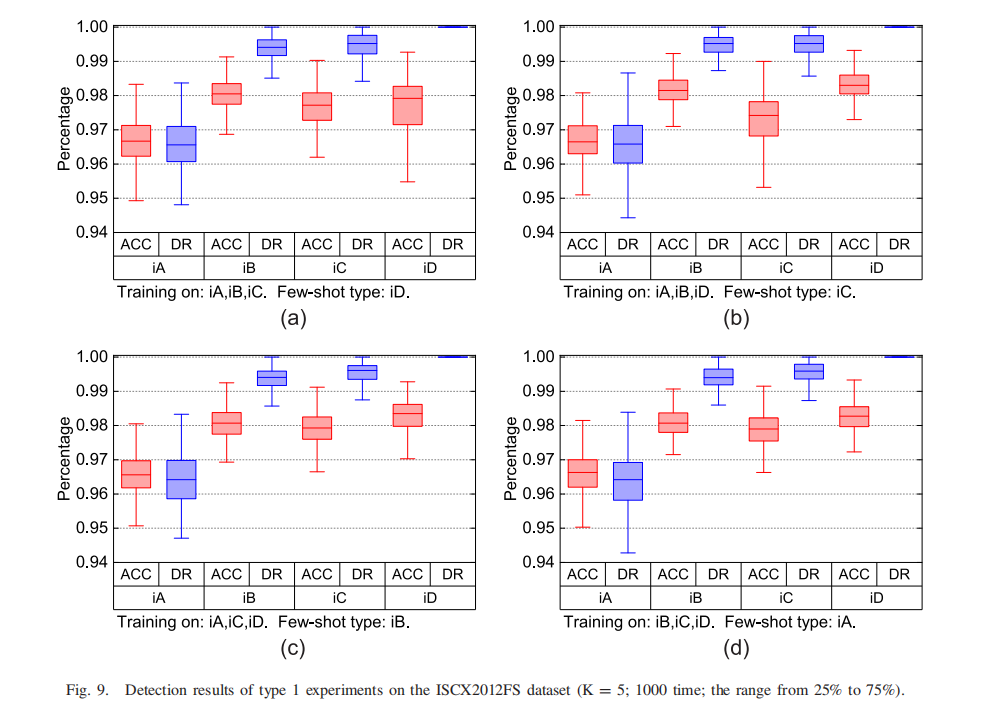

Congyuan Xu, et al. A Method of Few-Shot Network Intrusion Detection Based on Meta-Learning Framework. IEEE TIFS.
Ning Wang, et al. MANDA: On Adversarial Example Detection for Network Intrusion Detection System. IEEE INFOCOM.
Vipin Kumar Kukkala, INDRA: Intrusion Detection Using Recurrent Autoencoders in Automotive Embedded Systems. IEEE TRANSACTIONS ON COMPUTER-AIDED DESIGN OF INTEGRATED CIRCUITS AND SYSTEMS.
评估算法的混淆矩阵如下:

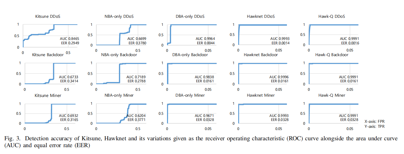

(3) Sunwoo Ahn, et al. Hawkware: Network Intrusion Detection based on Behavior Analysis with ANNs on an IoT Device. IEEE DAC.
We have implemented a prototype of Hawkware on a Raspberry Pi 3 Model B+ board which has a 1.4 GHz quad-core ARM Cortex-A53 processor with 1 GB RAM as it resembles many ARM-based IoT devices. We bound Hawkware to a single core for its computation with a 32 bit Linux OS.
We incorporated Tshark, a network packet capturing and analyzing tool, in implementing PA and used ftrace, an event tracing framework available in Linux kernels, in SCL. FP and HC are implemented in Python. Hawknet is trained offline on a separate server and then deployed on devices to perform detection. Hawknet and its training code are implemented with Tensorflow, which is one of the most popular frameworks for machine learning.
However, directly deploying this model strains IoT devices. In order to mitigate this issue, we first leveraged ARM’s NEON SIMD instructions to accommodate the high degree of parallelism inherent in Hawknet. Unfortunately, due to the high memory pressure in ANN computation for loading its weight values, utilizing NEON alone still falls short of making Hawknet efficient enough for IoT devices. Therefore, in addition, we capitalized on ANN weight quantization [15], compressing the vector values of Hawknet from 32-bit floating point numbers to 8-bit fixed point numbers. The compressed model of Hawknet, generated by employing the Tensorflowlite, only occupies 60KB. The learning rate was set to 0.001, which is a standard starting point for typical deep learning. The number of parameters in each layer of Hawknet is set as following: NBA’s embedding layer, encoding layer, decoding layer and reconstruction layer each respectively have 297, 3840, 567 and 297 parameters, DBA’s embedding layer, LSTM layer and softmax layer each have 3160, 840 and 3476 parameters and there are 210 parameters for CC.
