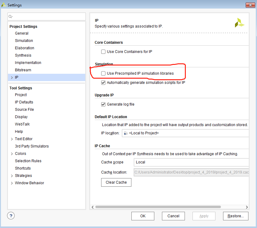

In Settings of Vivado GUI, you can find IP project setting. Disable the option " Use Precompiled IP simulation libraries ".

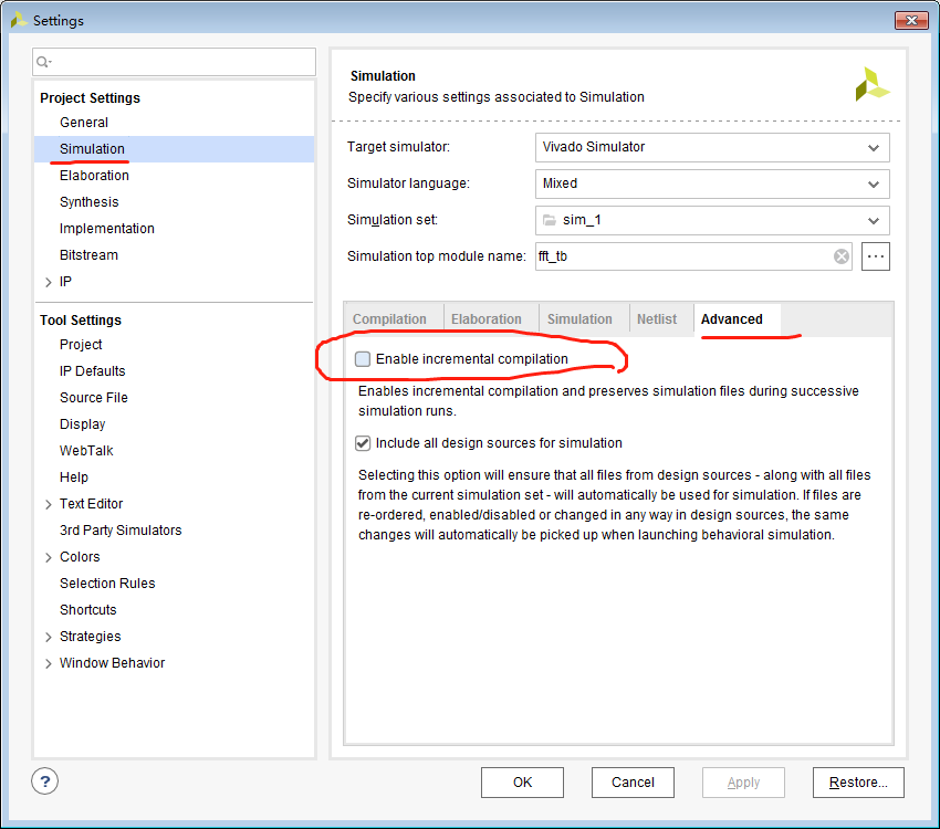

Also, go to Simulation in IP project setting. Go to Advanced and disable incremental compilation.
Hope that works for you.

不要勾选预编译:
不要勾选增量编译:
保存更改,之后执行行为仿真,问题得到了解决。
