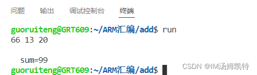

最后,用实现《输入三个数然后求和输入》来验证我们是否学会呀!
源代码:
.data
    fmt:.asciz "\n  sum=%d\n"
    fmt1:.asciz "%d %d %d"
    a:.word 0
    b:.word 0
    c:.word 0
.text
.globl main
main:
    stmfd sp!,{lr}
        ldr r0, =fmt1
        ldr r1,=a
        ldr r2,=b
        ldr r3,=c
        bl scanf
    ldr r1,=a
    ldr r1,[r1]
    ldr r2,=b
    ldr r2,[r2]
    ldr r3,=c
    ldr r3,[r3]
    add r2,r1
    add r3,r2
        ldr r0,=fmt
        mov r1,r3
        bl printf
    mov r0,#0
    ldmfd sp!,{lr}
    mov pc,lr
.end
结果:
