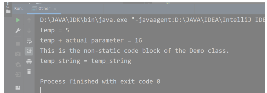

类的五大成员简单演示 :
package knowledge.inner.introduction;
public class Demo {
    //1.properties
    public static final int temp = 5;
    private String string = "temp_string";
    //2.methods
    public String getString() {
        return string;
    public static int tempSum(int parameter) {
        return temp + parameter;
    //3.constructor
    public Demo() {
    //4.code block
        System.out.println("This is the non-static code block of the Demo class.");
    //5.inner class
    class Inner_demo {
        class Inner_inner_demo {
class Other {
        System.out.println("temp = " + Demo.temp);
        System.out.println("temp + actual parameter = " + Demo.tempSum(11));
        System.out.println("temp_string = " + new Demo().getString());
运行结果 :

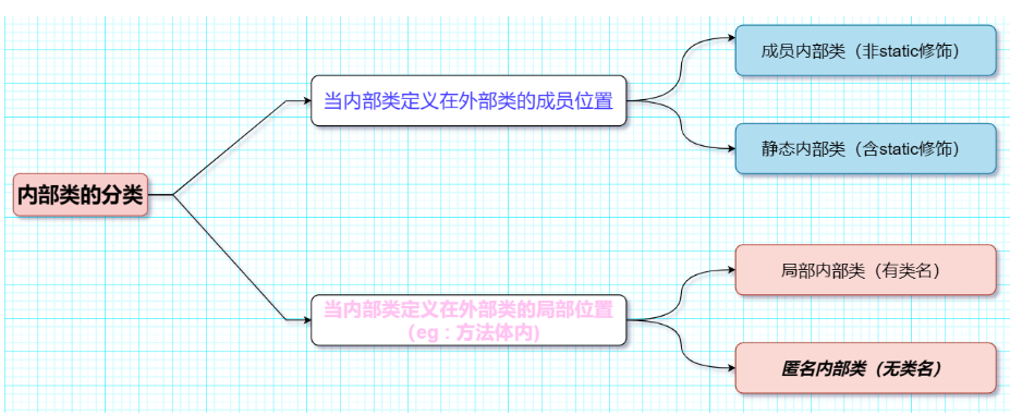

三、内部类的分类 :
0.概念图 :

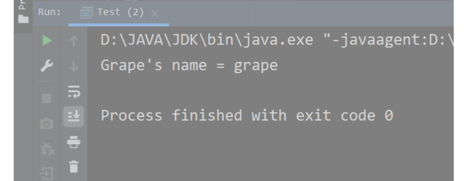

③演示 :
1°外部类访问成员内部类的演示 :
package knowledge.oop.inner.member;
public class Fruit {
    public class Grape {    //成员内部类
        private String name = "grape";
    public void showName() {
        Grape grape = new Grape();
        System.out.println("Grape's name = " + grape.name);
class Test {
        Fruit fruit = new Fruit();
        fruit.showName();
运行结果 :

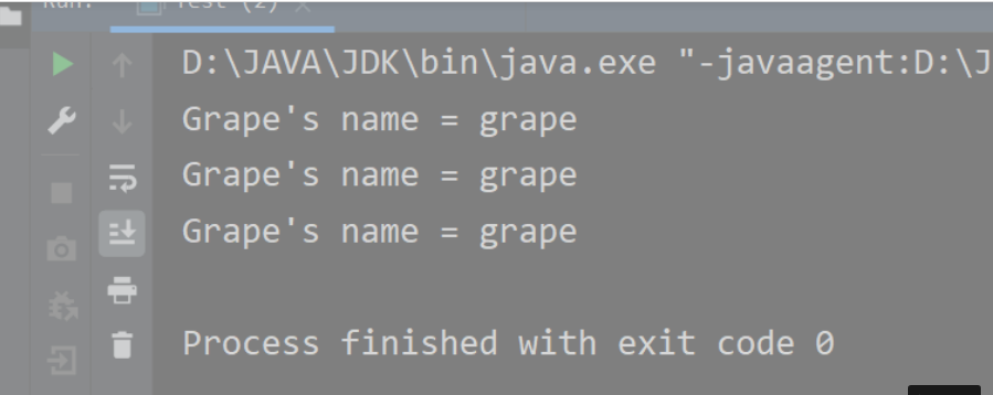

public class Fruit {    //外部类
        public String getName() {
            return name;
    public Grape getGrapeInstance() {
        return new Grape();
class People {      //外部其他类
    public void eatGrape() {
        //方式一
        Fruit.Grape grape_0 = fruit.new Grape();
        System.out.println("Grape's name = " + grape_0.getName());
        //方式二
        Fruit.Grape grape_1 = fruit.getGrapeInstance();
        System.out.println("Grape's name = " + grape_1.getName());
        //方式三   即方式二的链式编程形式。
        Fruit.Grape grape_2 = new Fruit().getGrapeInstance();
        System.out.println("Grape's name = " + grape_2.getName());
class Test {
        People people = new People();
        people.eatGrape();
运行结果 :

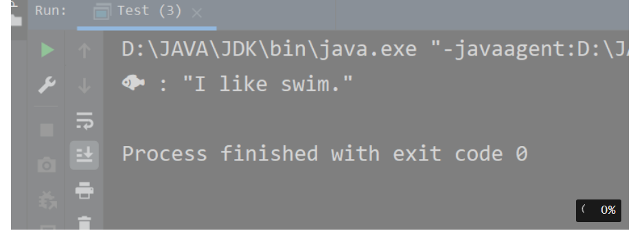

    public static class Fish {
        public void swim() {
            System.out.println("🐟 : \"I like swim.\"");
    public void skill() {
        Fish fish = new Fish();
        fish.swim();
class Test {
        Animal animal = new Animal();
        animal.skill();
运行结果 :

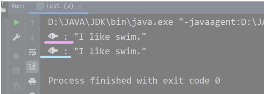

2°外部其他类访问静态内部类的两种方式演示 :
package knowledge.oop.inner.staticinner;
public class Animal {           //外部类
    public static class Fish {  //静态内部类
    public static Fish getFishInstance() {      //静态就通过类名调用
        return new Fish();
    //public Fish getFishInstance() { return new Fish(); }  //非静态就通过对象调用
    public void eatFish() {
        //方式一 :
        Animal.Fish fish = new Animal.Fish();
        fish.swim();
        //方式二 :
        Animal.Fish fish_EX = Animal.getFishInstance();
        fish_EX.swim();
class Test {
        people.eatFish();
运行结果 :

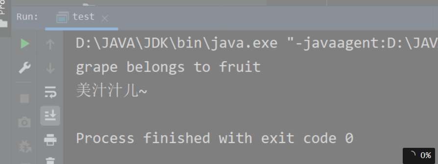

③演示 :
package knowledge.inner.locality;
    private String name = "fruit";
    public static void juice() {
        System.out.println("美汁汁儿~");
    public void test() {
        final class Grape {
            public void relationship() {
                System.out.println(this.name + " belongs to " + Fruit.this.name);
                juice();    //invoke directly
        new Grape().relationship();
       /* class SunshineRose extends Grape {
            //Grape类被final关键字修饰,因此不能被继承。
class test {
        fruit.test();
运行结果 :

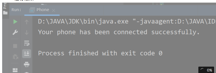

举个例子——定义Phone类去实现Use接口 :
package knowledge.oop.inner.anonymous;
public interface Usb {
    public abstract void connect();
class Phone implements Usb {
    @Override
    public void connect() {
        System.out.println("Your phone has been connected successfully.");
        Usb usb = new Phone();
        usb.connect();
运行结果 :
以上是传统的方式——写一个类--> 实现目标接口 --> 创建实现类对象 --> 调用实现后的方法

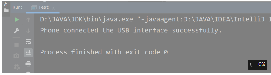

现在给出解决方案,使用匿名类,如下 :
class Solution {
    public void invoke_usb() {
        Usb phone = new Usb() {    This an anonymous class.
            @Override
                System.out.println("Phone connected the USB interface successfully.");
        };  //Don's forget the last semicolon.
        phone.connect();
class Test {
        Solution solution = new Solution();
        solution.invoke_usb();
运行结果 :
使用匿名内部类可以简化开发。

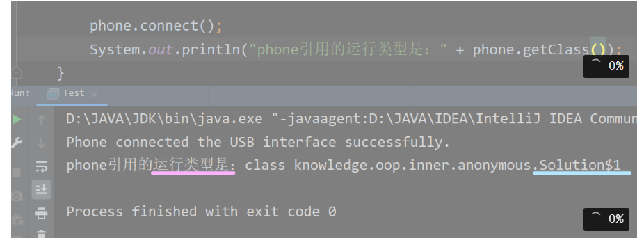

此时,对于phone引用来讲,它的编译类型是Usb型,也就是Usb接口,而它的运行类型是匿名内部类。该匿名内部类此时的默认类名是“外部类类名 + $1"。($1是按照匿名内部类的定义顺序来编号的)。如下 :
其实底层就相当于这么写 :

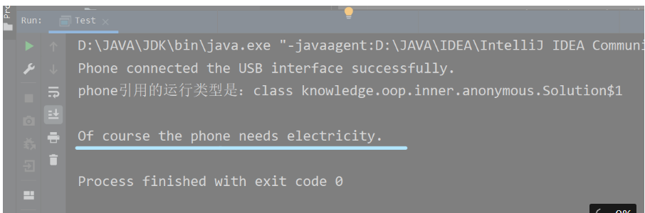

③基于类的匿名内部类 :
在以上代码的基础上,增加一个Electronics类(电子产品类)。如下 :
class Solution {
            @Override
        phone.connect();
        System.out.println("phone引用的运行类型是:" + phone.getClass());
        System.out.println();
        Electronics mobile = new Electronics() {
            @Override
            public void energy() {
                System.out.println("Of course the phone needs electricity.");
        };  //Don't forget the last semicolon.
        mobile.energy();
        System.out.println("mobile引用的运行类型是:" + mobile.getClass());
class Test {
class Electronics {
    public Electronics() {}
    public void energy() {}
运行结果 :

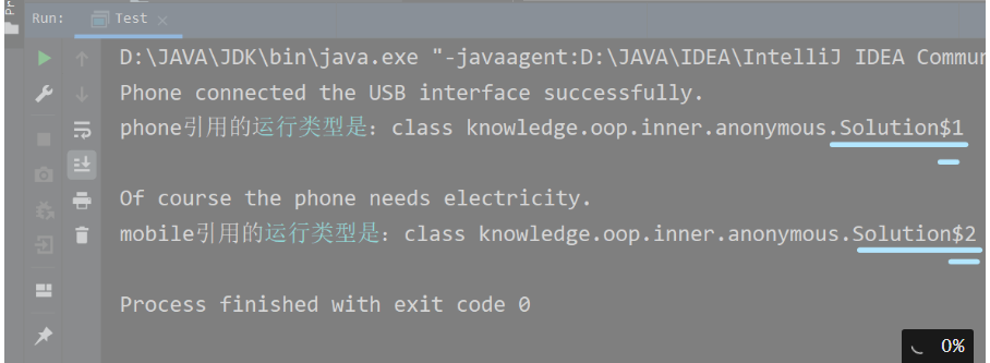

注意看第二个匿名内部类的类名,编号改为了$2。
基于类的匿名内部类与基于接口的匿名内部类底层逻辑类似。如下 :
class Solution$2 extends Electronics {
        @Override

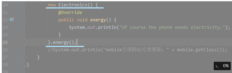

④调用方式 :
匿名内部类的调用方式有两种——
一种就如我们上面举得栗子。先创建一个引用来接收匿名内部类的对象,在通过引用来调用匿名内部类中实现或者是重写后的方法还有一种就是不做接收,直接在匿名内部类后面通过“.”的形式来调用方法。(∵根据底层的操作来看,最终返回的就是一个匿名内部类的对象,即把它当成对象看待。)
仍然以上面代码为例,仅改变第二个匿名内部类Solution$2的调用方式。如下图所示 :
运行结果 :

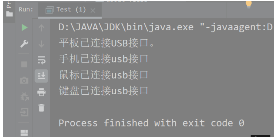

⑥应用——匿名内部类作形参 :
在接口多态参数的基础上(接口类型作为形参),传递实参时以匿名内部类作为实参,可以极大地简化代码。
以接口多态参数中的Usb接口等为例,不一样的是,不再创建Phone类,Mouse类等实现类而是在传递实参时,直接将它们写成匿名内部类的形式代码如下 :
package knowledge.oop.inner.application;
    void connect();
class ConnectUsb {
    public void connect(Usb usb) {
        usb.connect();
class Test {
        ConnectUsb connectUsb = new ConnectUsb();
        connectUsb.connect(new Usb() {
            @Override
                System.out.println("平板已连接USB接口。");
            @Override
                System.out.println("手机已连接usb接口");
            @Override
                System.out.println("鼠标已连接usb接口");
            @Override
                System.out.println("键盘已连接usb接口");
运行结果 :
