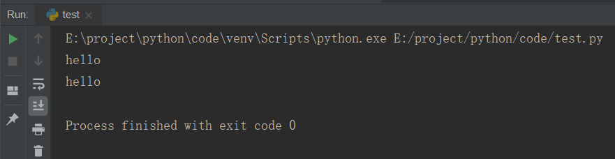

# 模块别名
import time as tt
tt.sleep(2)
print('hello')
# 功能别名
from time import sleep as sl
sl(2)
print('hello')
