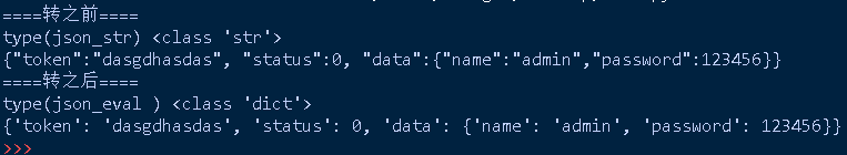

说明:

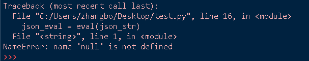

字符串里有个null,转了之后变成了None,已经变成Python格式的需求了,但是这个时候我们直接使用eval()进行转的话,可能会报错,提示‘null’没有定义,所以如果有布尔类型的字符串转字段时候使用loads()、没有的话直接使用eval()也可以
# -*- coding:utf-8 -*-
import json
json_str = '{"token":"dasgdhasdas", "status":0, "data":{"name":"admin", "password":123456}, "author":null}'
json_dict = json.loads(json_str)
print("====转之前====")
print("type(json_str)", type(json_str))
print(json_str)
print("====转之后====")
print("type(json_dict)", type(json_dict))
print(json_dict)
json_eval = eval(json_str)

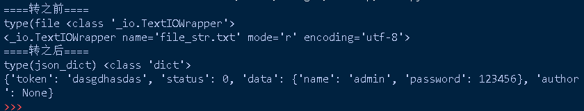

作用:
从文件中读取json类型的数据,并转化为字典类型
示例:
import json
# json_str = '{"token":"dasgdhasdas", "status":0, "data":{"name":"admin", "password":123456}, "author":null}'
# 文件中内容和json_str是一样的
with open("file_str.txt", mode="r", encoding="utf-8") as file:
    json_dict = json.load(file)
print("type(file", type(file))
print(file)
print(json_dict)

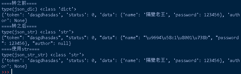

作用:
将Python中特定类型进行字符串化操作,即转换为json格式的数据
示例:
import json
json_dic = {"token":"dasgdhasdas", "status":0, "data":{"name":"隔壁老王", "password":123456}, "author":None}
json_str = json.dumps(json_dic)
json_str_str = str(json_dic)
print("type(json_dic)", type(json_dic))
print(json_dic)
print(json_str)
print("====使用str====")
print("type(json_str_str)", type(json_str_str))
print(json_str_str)

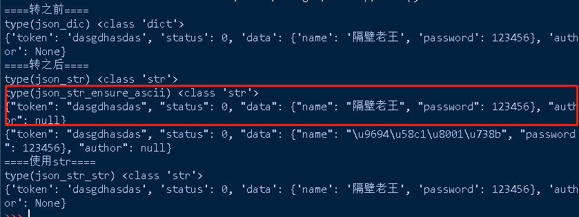

说明:
其实就类似于直接用str()进行强制转换,但是dumps()转了之后,有中文的被编码了,那这个时候如果有中文的话,在转换的时候,加ensure_ascii=False,如下:
import json
json_str_ensure_ascii = json.dumps(json_dic, ensure_ascii=False)
print(json_dic)
print("type(json_str_ensure_ascii)", type(json_str_ensure_ascii))
print(json_str_ensure_ascii)
print(json_str)
print(json_str_str)

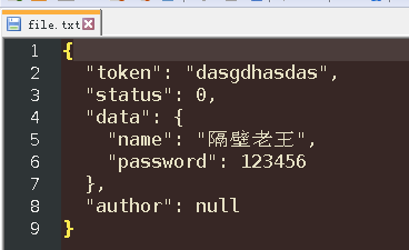

作用:
将字典类型转化为json字符串格式,写入到文件中
import json
with open("file.txt", mode="a", encoding="utf-8") as file:
    json.dump(json_dic, file, ensure_ascii=False, indent=2)

示例:
import json
json_str = '{"token":"dasgdhasdas", "status":0, "data":{"name":"admin","password":123456}}'
print(json_str)
print("type(json_eval )", type(json_eval ))
print(json_eval)
