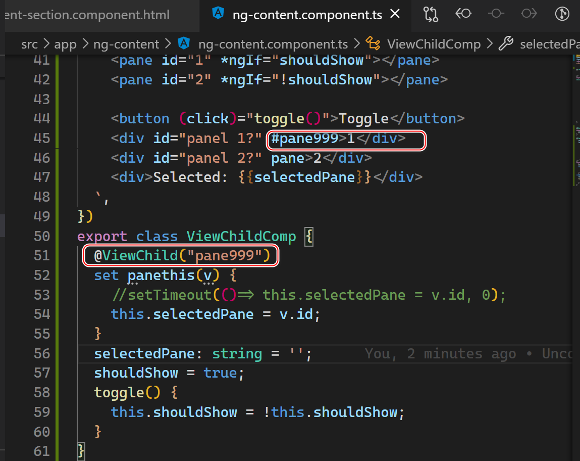

我的 Component 里有一个 selectedPane 字段(第56行),作为数据源显示在 div 标签里(代码第47行):
代码第 51 行,我使用 @ViewChild 这个 query,将第 45 行的 div 元素,查询出来并通过 52 行的 set 函数,赋给 this.selectedPane.

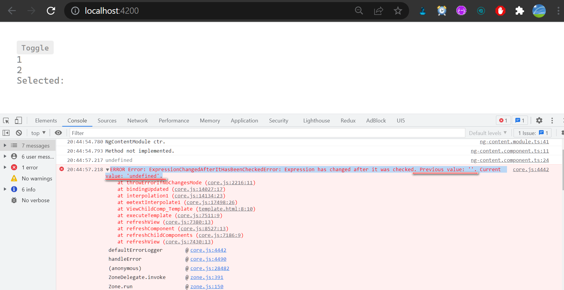

运行时收到这条错误消息:
ERROR Error: ExpressionChangedAfterItHasBeenCheckedError: Expression has changed after it was checked. Previous value: ‘’. Current value: ‘undefined’.

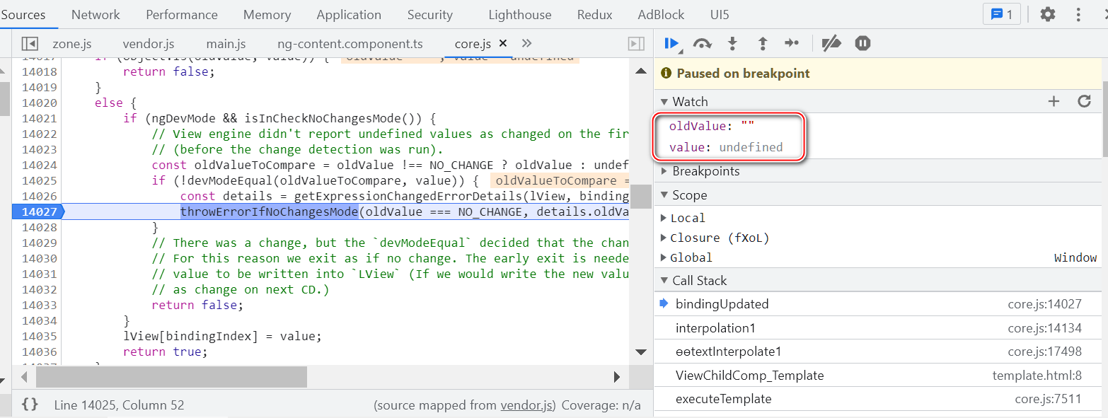

从调试器里能看出,旧的 value 是 “”, 新的 value 是 undefined,因此抛出异常:
if (ngDevMode && isInCheckNoChangesMode()) {
            // View engine didn't report undefined values as changed on the first checkNoChanges pass
            // (before the change detection was run).
            const oldValueToCompare = oldValue !== NO_CHANGE ? oldValue : undefined;
            if (!devModeEqual(oldValueToCompare, value)) {
                const details = getExpressionChangedErrorDetails(lView, bindingIndex, oldValueToCompare, value);
                throwErrorIfNoChangesMode(oldValue === NO_CHANGE, details.oldValue, details.newValue, details.propName);
            // There was a change, but the `devModeEqual` decided that the change is exempt from an error.
            // For this reason we exit as if no change. The early exit is needed to prevent the changed
            // value to be written into `LView` (If we would write the new value that we would not see it
            // as change on next CD.)
            return false;

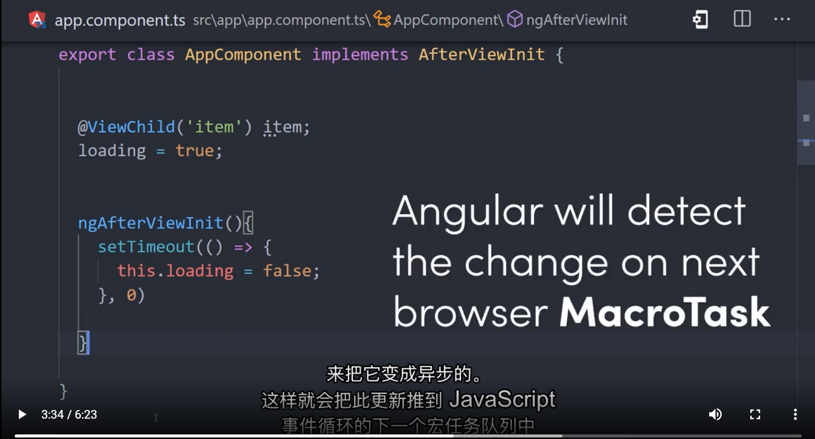

一种 StackOverflow 上经常提到的解决方案就是,使用异步更新, 将值的修改推迟到下一次变更检测周期中执行:
使用 setTimeout 配合延迟为 0 的调用方式,使得这个更新对应的检测,发生在下一次浏览器的宏任务队列中。
采用立即执行的 Promise 可以达到同样的效果:
Promise.resolve().then(() => this.loading false);
错误消失了:
