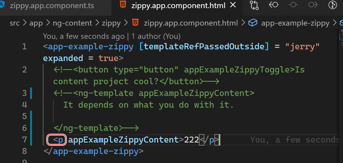

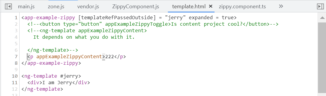

我有一个能接受内容投影的 Angular Component:

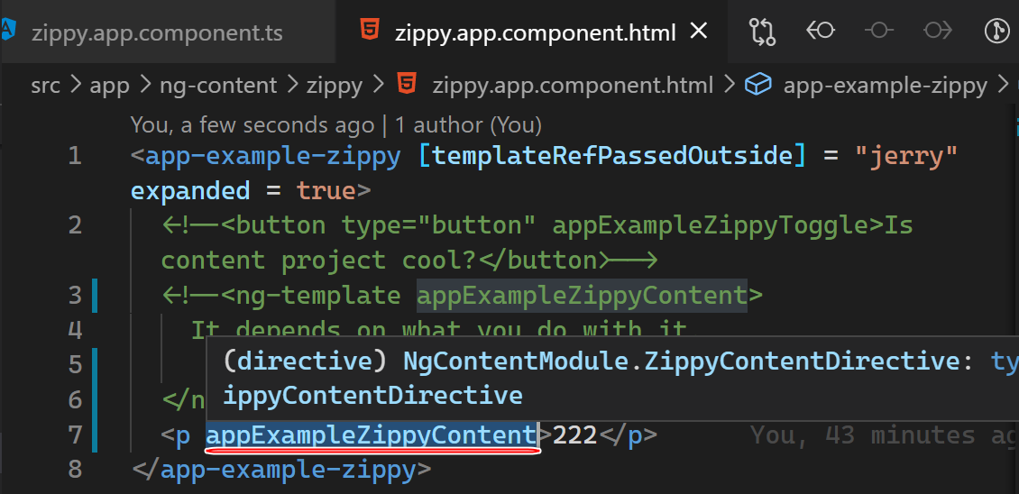

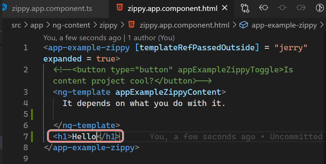

使用如下代码消费这个 Component:

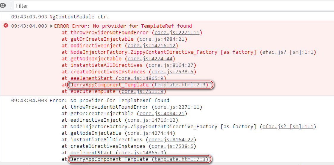

但是遇到运行时错误,如下图所示。
点击 template.html:7:3:

抛出该错误消息的函数实现:
 * Returns the value associated to the given token from the NodeInjectors => ModuleInjector.
 * Look for the injector providing the token by walking up the node injector tree and then
 * the module injector tree.
 * This function patches `token` with `__NG_ELEMENT_ID__` which contains the id for the bloom
 * filter. Negative values are reserved for special objects.
 *   - `-1` is reserved for injecting `Injector` (implemented by `NodeInjector`)
 * @param tNode The Node where the search for the injector should start
 * @param lView The `LView` that contains the `tNode`
 * @param token The token to look for
 * @param flags Injection flags
 * @param notFoundValue The value to return when the injection flags is `InjectFlags.Optional`
 * @returns the value from the injector, `null` when not found, or `notFoundValue` if provided

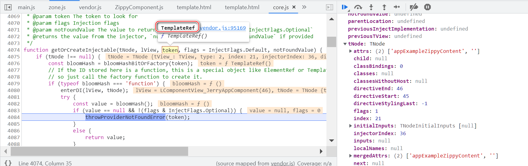

function getOrCreateInjectable(tNode, lView, token, flags = InjectFlags.Default, notFoundValue)

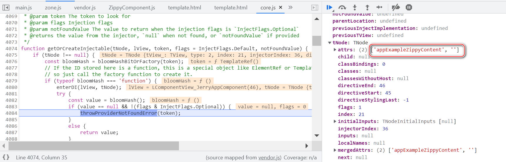

第一个输入参数 tnode 就是 p 节点本身:
token 指向 TemplateRef:

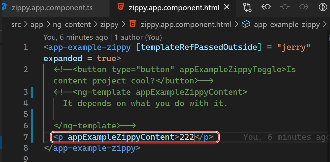

方案1

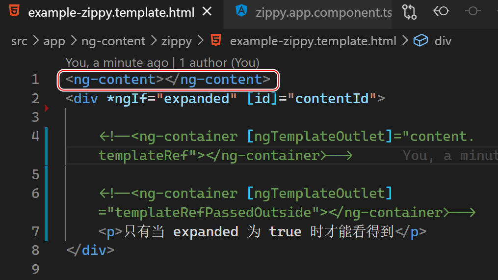

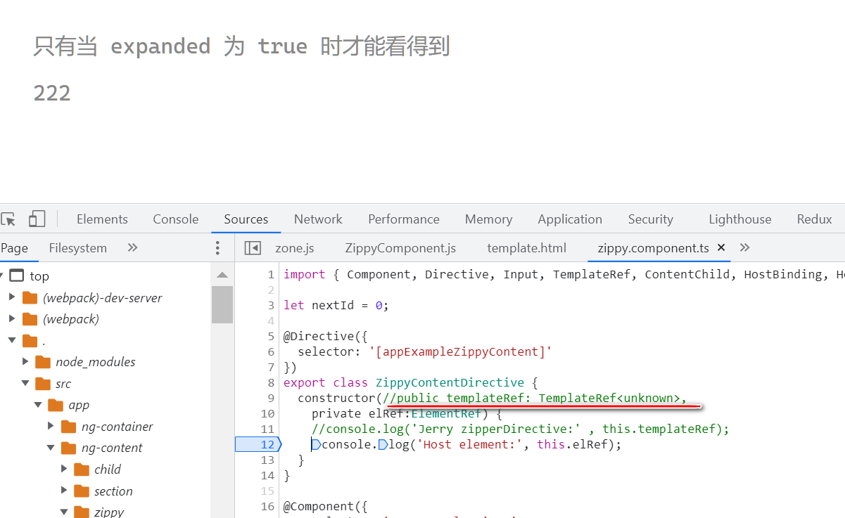

删除 p 节点的自定义 Directive:
然后添加一个默认的内容投影:

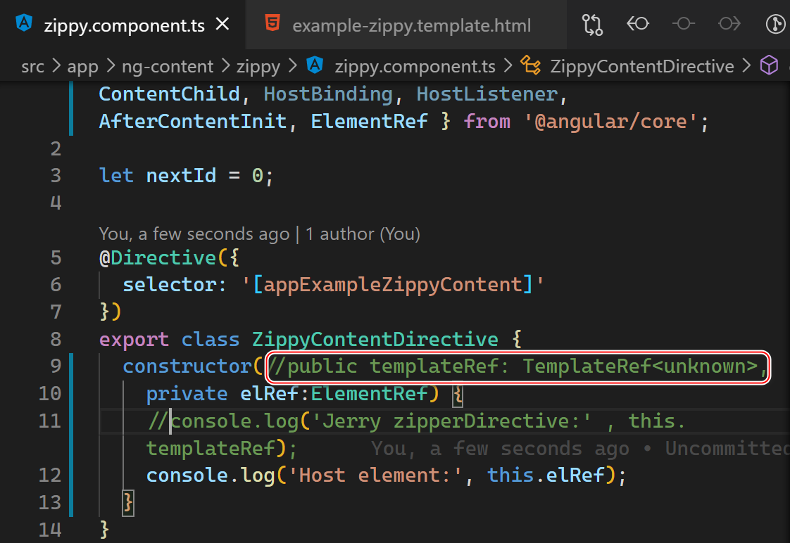

解决方案2
删除自定义 Directive 构造函数里的 TemplateRef 依赖:

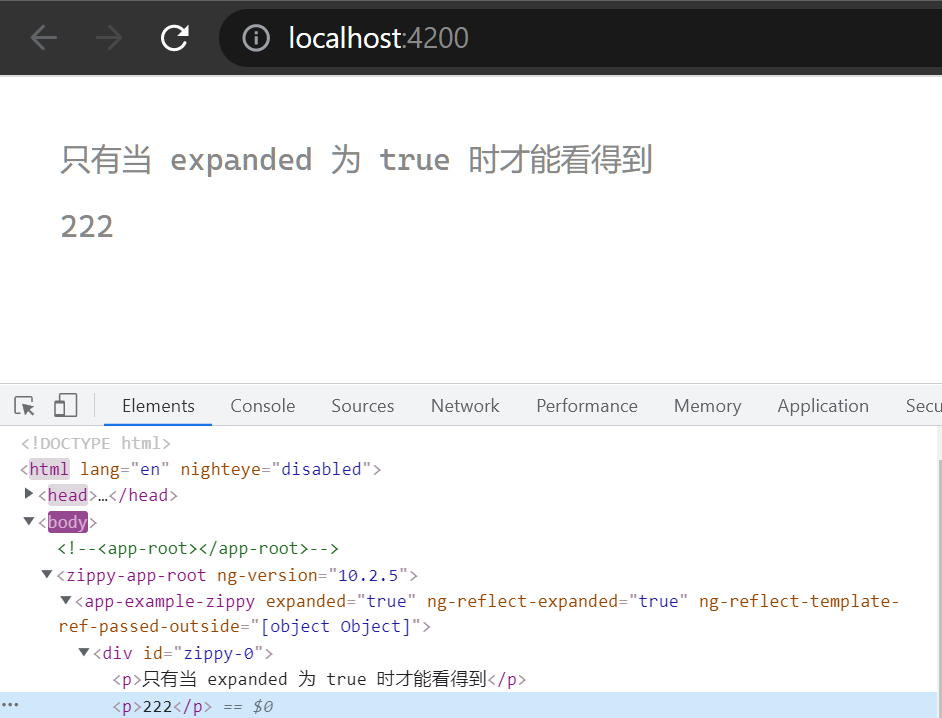

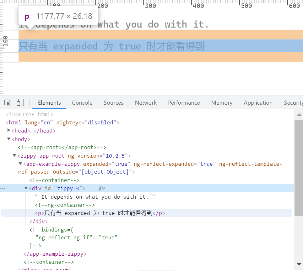

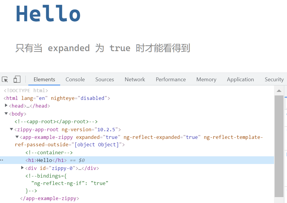

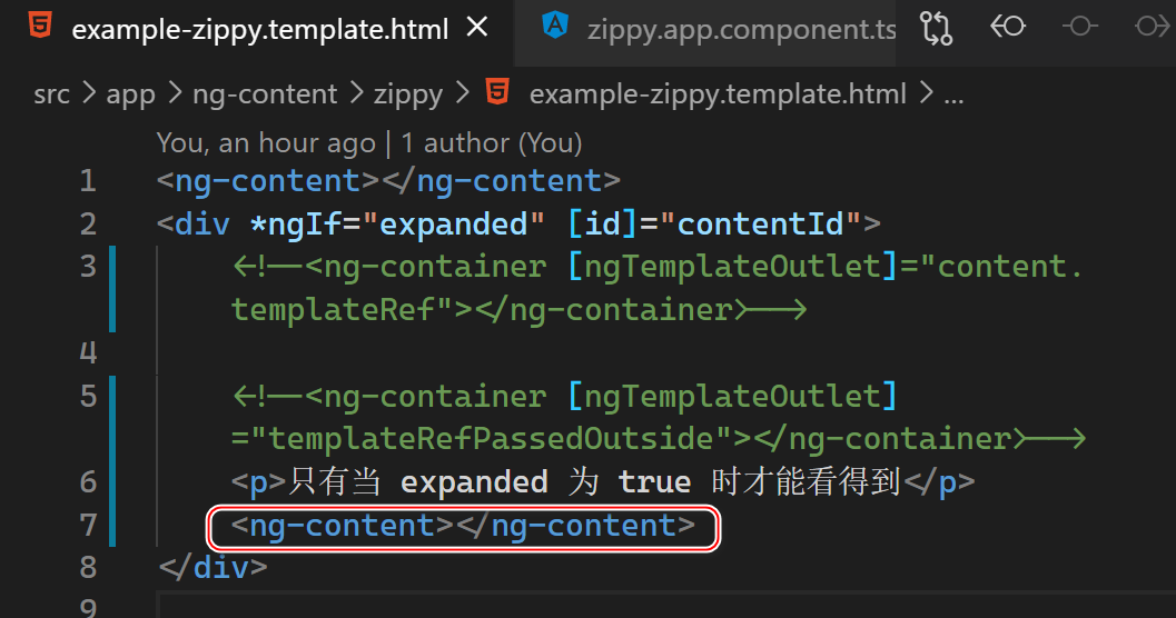

消费 zippy Component 时,直接传入被投影的内容:
该内容会被投影到下图第一行的 place holder:

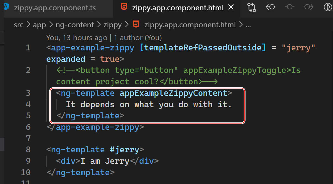

解决方案4
消费 Component 时,通过 ng-template + 自定义 Directive 的方式指定被投影的内容:

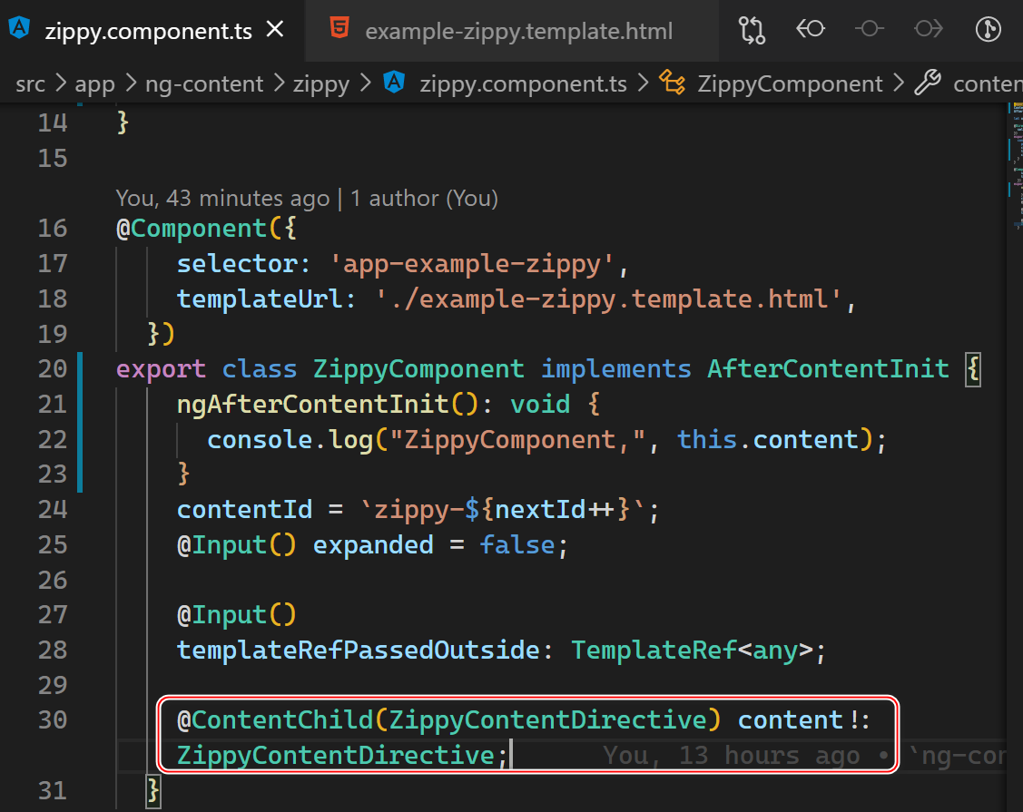

通过 @ContentChild conten query 拿到自定义 Directive 实例,进而拿到 Directive 指向的 TemplateRef:
