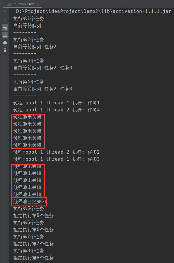

3.awaitTermination()
此方法阻塞,在shutdown()调用之后,停止接收新任务,但是awaitTermination()后可以继续提交,此方法是阻塞的,用来检测timeout时间后线程池是否终止,如果停止,则返回true并释放锁
public class ShutdownTest {
    public static void main(String[] args) throws InterruptedException {
        // 1.创建线程池
        ThreadPoolExecutor threadPoolExecutor = new ThreadPoolExecutor(1, 2, 5,
                TimeUnit.SECONDS,
                new ArrayBlockingQueue<>(2),
                Executors.defaultThreadFactory());
        // 2.创建线程任务
        for (int i = 1; i <= 8; i++) {
            // 3.执行任务
            System.out.println("执行第"+i+"个任务");
            try {
                threadPoolExecutor.execute(new runnable("任务"+i));
                // 4.获取等待队列
                Iterator iterator = threadPoolExecutor.getQueue().iterator();
                System.out.print("当前等待队列 ");
                while (iterator.hasNext()){
                    runnable thread = (runnable) iterator.next();
                    System.out.print(thread.name + "\t");
                System.out.print("\n");
                System.out.println("--------");
            } catch (RejectedExecutionException e) {
                // 5.捕获拒绝执行策略异常
                System.out.println("拒绝执行第" + i + "个任务");
            // 6.关闭线程池
            if (i == 4) {
                threadPoolExecutor.shutdown();
                while (!threadPoolExecutor.awaitTermination(1, TimeUnit.SECONDS)) {
                    System.out.println("线程池未关闭");
                System.out.println("线程池已经关闭");
    static class runnable implements Runnable{
        // 设置任务名
        String name;
        public runnable(String setName) {
            this.name = setName;
        @Override
        public void run() {
            try {
                System.out.println("线程:"+Thread.currentThread().getName() +" 执行: "+name);
                Thread.sleep(5000);
            } catch (Exception e) {
                e.printStackTrace();

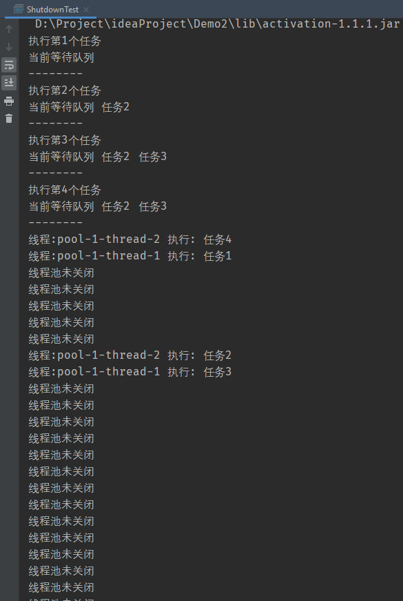

保证了线程池和其他线程的之间的执行顺序
如果 shutdown() 在 awaitTermination()后调用的话,awaitTermination()依然锁在等待终止状态,而 shutdown() 也无法得到锁去让线程池停止,这就形成了死锁
            // 6.关闭线程池
            if (i == 4) {
