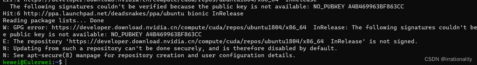

echo 'deb https://developer.download.nvidia.cn/compute/cuda/repos/ubuntu1804/x86_64' > /etc/apt/sources.list.d/cuda.list
  • 1
E: Malformed entry 1 in list file /etc/apt/sources.list.d/cuda.list (Suite)
E: The list of sources could not be read.
说明该方法不行
gpg --keyserver keyserver.ubuntu.com --recv-keys A4B469963BF863CC
sudo apt-key adv --keyserver keyserver.ubuntu.com --recv-keys A4B469963BF863CC
  • 1
  • 2
成功!
