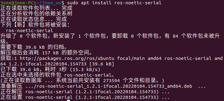

刚装的ros环境会报错,如下:
Make Error at /opt/ros/noetic/share/catkin/cmake/catkinConfig.cmake:83 (find_package):
  Could not find a package configuration file provided by "serial" with any
  of the following names:
    serialConfig.cmake
    serial-config.cmake
原因就是在CMakeList.txt文件中包含了 serial的功能包,需要进行安装
sudo apt install ros-noetic-serial
安装成功后会提示如下:
然后在进行 编译
catkin_make
就成功了

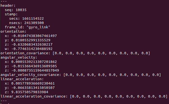

通过
rostopic list
查看当前消息列表
rostopic echo /imu
终端打印 imu消息
ROS使用成功
