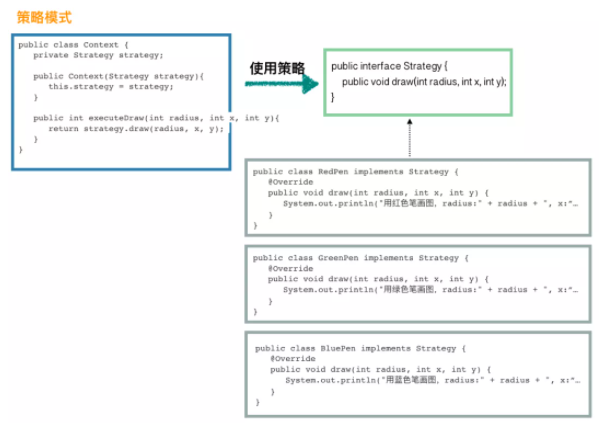

1.1策略模式
下面设计的场景是,需要画一个图形,可选的策略就是用红色笔来画,还是绿色笔来画,或者蓝色笔来画。
首先,先定义一个策略接口:
public interface Strategy {
   public void draw(int radius, int x, int y);
  • 1
  • 2
  • 3
然后定义具体的几个策略:
public class RedPen implements Strategy {
   @Override
   public void draw(int radius, int x, int y) {
      System.out.println("用红色笔画图,radius:" + radius + ", x:" + x + ", y:" + y);
public class GreenPen implements Strategy {
   @Override
      System.out.println("用绿色笔画图,radius:" + radius + ", x:" + x + ", y:" + y);
public class BluePen implements Strategy {
   @Override
      System.out.println("用蓝色笔画图,radius:" + radius + ", x:" + x + ", y:" + y);
  • 1
  • 2
  • 3
  • 4
  • 5
  • 6
  • 7
  • 8
  • 9
  • 10
  • 11
  • 12
  • 13
  • 14
  • 15
  • 16
  • 17
  • 18
  • 19
定义使用策略的类:
public class Context {
   private Strategy strategy;
   public Context(Strategy strategy){
      this.strategy = strategy;
   public int executeDraw(int radius, int x, int y){
      return strategy.draw(radius, x, y);
  • 1
  • 2
  • 3
  • 4
  • 5
  • 6
  • 7
  • 8
  • 9
  • 10
  • 11
  • 12
客户端调用:
    Context context = new Context(new BluePen()); // 使用绿色笔来画
    context.executeDraw(10, 0, 0);
  • 1
  • 2
  • 3
  • 4
