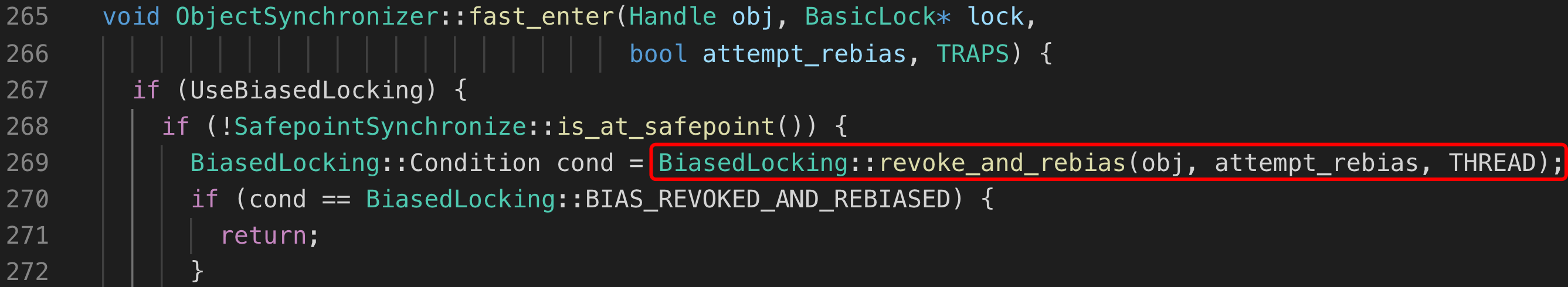

偏向锁的入口,synchronizer.cpp 文件的
ObjectSynchronizer::fast_enter
BiasedLocking::revoke_and_rebias实现

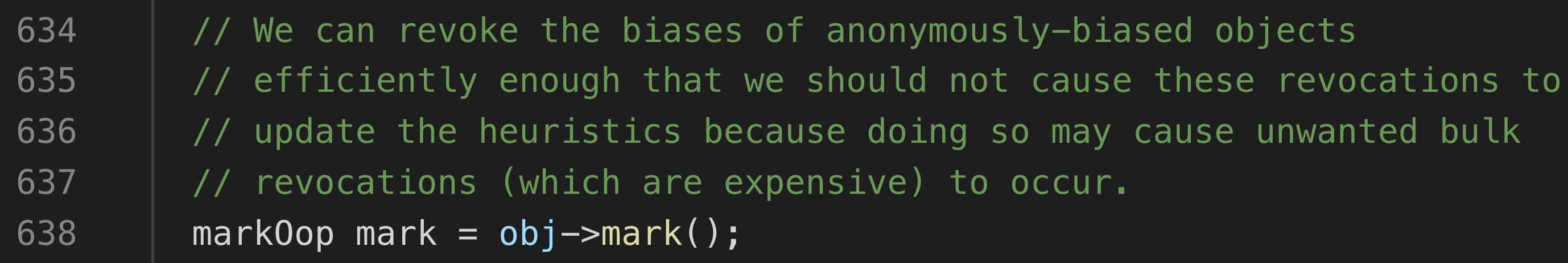

BiasedLocking::Condition BiasedLocking::revoke_and_rebias(Handle obj, bool attempt_rebias, TRAPS) {
  assert(!SafepointSynchronize::is_at_safepoint(), "must not be called while at safepoint");
  // We can revoke the biases of anonymously-biased objects
  // efficiently enough that we should not cause these revocations to
  // update the heuristics because doing so may cause unwanted bulk
  // revocations (which are expensive) to occur.
  // step1
  markOop mark = obj->mark();
