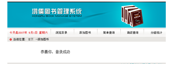

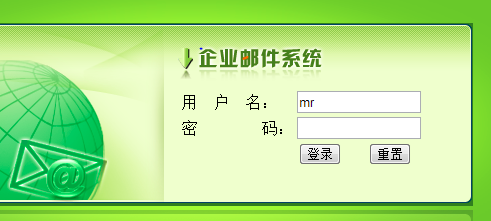

  1. Session对象应用:Session对象的用途有很多,如存储变量,判断用户是否登录等。例:
(1)登录页面
代码:
protected void btnLogin_Click(object sender, EventArgs e)
        if (txtName.Text == "mr" && txtPwd.Text == "mrsoft")
        {//使用Session变量记录用户名
                    Session["UserName"] = txtName.Text;
//使用Session变量记录用户登录系统的时间                               Session["TimeLogin"] = DateTime.Now;
            Response.Redirect("~/UserPage.aspx");//跳转到主页
        else
            Response.Write("<script>alert('登录失败!请返回查找原因');location='Login.aspx'</script>");
(2)Session对象记录用户登录名及登录时间
  protected void Page_Load(object sender, EventArgs e)
        Response.Write("欢迎用户" + Session["UserName"].ToString() + "登录本系统!<br>");
        Response.Write("您登录的时间为:" + Session["TimeLogin"].ToString());

例4、创建一个网站,使用Response对象的Redirect方法实现页面跳转并传递参数。
Default.aspx页面
  protected void Button1_Click(object sender, EventArgs e)
        //获取用户名和密码
        string name = txtUserName.Text.Trim();
        string pwd = txtPwd.Text.Trim();
        string strsql = "select count(1) from tb_user where userName='" + name + "' and userPwd='" + pwd + "'";
        SqlConnection conn =new SqlConnection(System.Configuration.ConfigurationManager.AppSettings["conn"].ToString());
        conn.Open();
        SqlCommand cmd = new SqlCommand(strsql, conn);
        int flag = int.Parse(cmd.ExecuteScalar().ToString());
        conn.Close();
        if (flag > 0)
            Session["users"] = name;
            Response.Redirect("admin.aspx");
        else
            ClientScript.RegisterStartupScript(this.GetType(), "", "alert('用户名或密码错误');", true);
Admin.aspx
        if (!IsPostBack)
            if (Session["users"] != null)
                lblinfo.Text = "恭喜你,登录成功";
