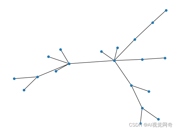

无向图示例:
  1. import networkx as nx
  2. import matplotlib.pyplot as plt
  3. # BA scale-free degree network
  4. # generalize BA network which has 20 nodes, m = 1
  5. BA = nx.random_graphs.barabasi_albert_graph(20, 1)
  6. # spring layout
  7. pos = nx.spring_layout(BA)
  8. nx.draw(BA, pos, with_labels = False, node_size = 30)
  9. plt.show()

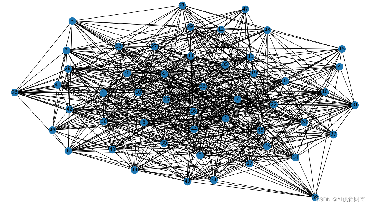

  1. # 导入相关依赖
  2. from matplotlib import pyplot as plt
  3. import networkx as nx
  4. import numpy as np
  5. # 生成随机数据
  6. G = nx.erdos_renyi_graph(50,0.5)
  7. # 指定画布大小
  8. plt.figure(figsize=(18,18))
  9. # 生成新的图
  10. G_new = nx.Graph()
  11. # 依据图中边的数量,生成同样长度的随机权重值
  12. weightList = {}
  13. for i in range(len(G.edges())+1):
  14. weightList[i] = np.random.rand()
  15. # 将生成的随机权重复制给G_new图
  16. i = 0
  17. for edge in G.edges():
  18. i += 1
  19. G_new.add_edges_from([(edge[0], edge[1], {'weight': weightList[i]})])
  20. # 绘制G_new图
  21. nx.draw_networkx(G_new)
  22. plt.show()
