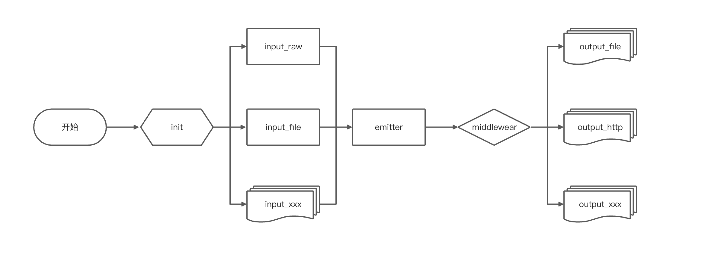

三、主要核心流程
goreplay 只有 input 和 output 两个概念,是 goreplay 对数据流的抽象,统称为 plugin。
gor.go 中 main 函数,它主要做了以下事情:

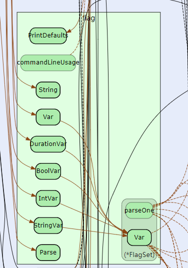

  1. 命令行参数的定义在 settings.go 的 init 函数中,会先于 main 函数执行。
func init() {
	flag.Usage = usage
	flag.StringVar(&Settings.Pprof, "http-pprof", "", "Enable profiling. Starts  http server on specified port, exposing special /debug/pprof endpoint. Example: `:8181`")
	flag.IntVar(&Settings.Verbose, "verbose", 0, "set the level of verbosity, if greater than zero then it will turn on debug output")
	flag.BoolVar(&Settings.Stats, "stats", false, "Turn on queue stats output")
	if DEMO == "" {
		flag.DurationVar(&Settings.ExitAfter, "exit-after", 0, "exit after specified duration")
	} else {
		Settings.ExitAfter = 5 * time.Minute
	flag.BoolVar(&Settings.SplitOutput, "split-output", false, "By default each output gets same traffic. If set to `true` it splits traffic equally among all outputs.")
	flag.BoolVar(&Settings.RecognizeTCPSessions, "recognize-tcp-sessions", false, "[PRO] If turned on http output will create separate worker for each TCP session. Splitting output will session based as well.")
	// default values, using for tests
	Settings.OutputFileConfig.SizeLimit = 33554432
	Settings.OutputFileConfig.OutputFileMaxSize = 1099511627776
	Settings.CopyBufferSize = 5242880

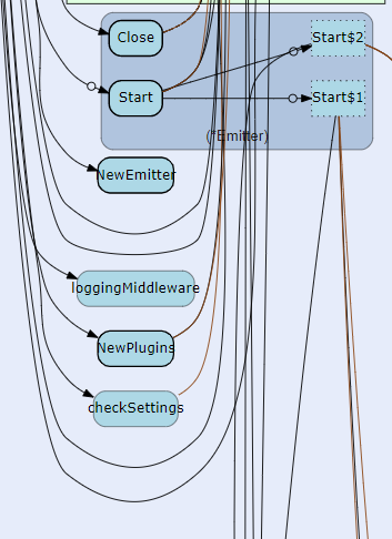

  1. 调用 Start 函数,启动 emitter,每个 input 插件,都启动一个协程,读取 input,写 output。​
/ Start initialize loop for sending data from inputs to outputs
func (e *Emitter) Start(plugins *InOutPlugins, middlewareCmd string) {
	if Settings.CopyBufferSize < 1 {
		Settings.CopyBufferSize = 5 << 20
	e.plugins = plugins
	if middlewareCmd != "" {
		middleware := NewMiddleware(middlewareCmd)
		for _, in := range plugins.Inputs {
			middleware.ReadFrom(in)
		e.plugins.Inputs = append(e.plugins.Inputs, middleware)
		e.plugins.All = append(e.plugins.All, middleware)
		e.Add(1)
		go func() {
			defer e.Done()
			if err := CopyMulty(middleware, plugins.Outputs...); err != nil {
				Debug(2, fmt.Sprintf("[EMITTER] error during copy: %q", err))
	} else {
			e.Add(1)
			go func(in PluginReader) {
				defer e.Done()
				if err := CopyMulty(in, plugins.Outputs...); err != nil {
			}(in)

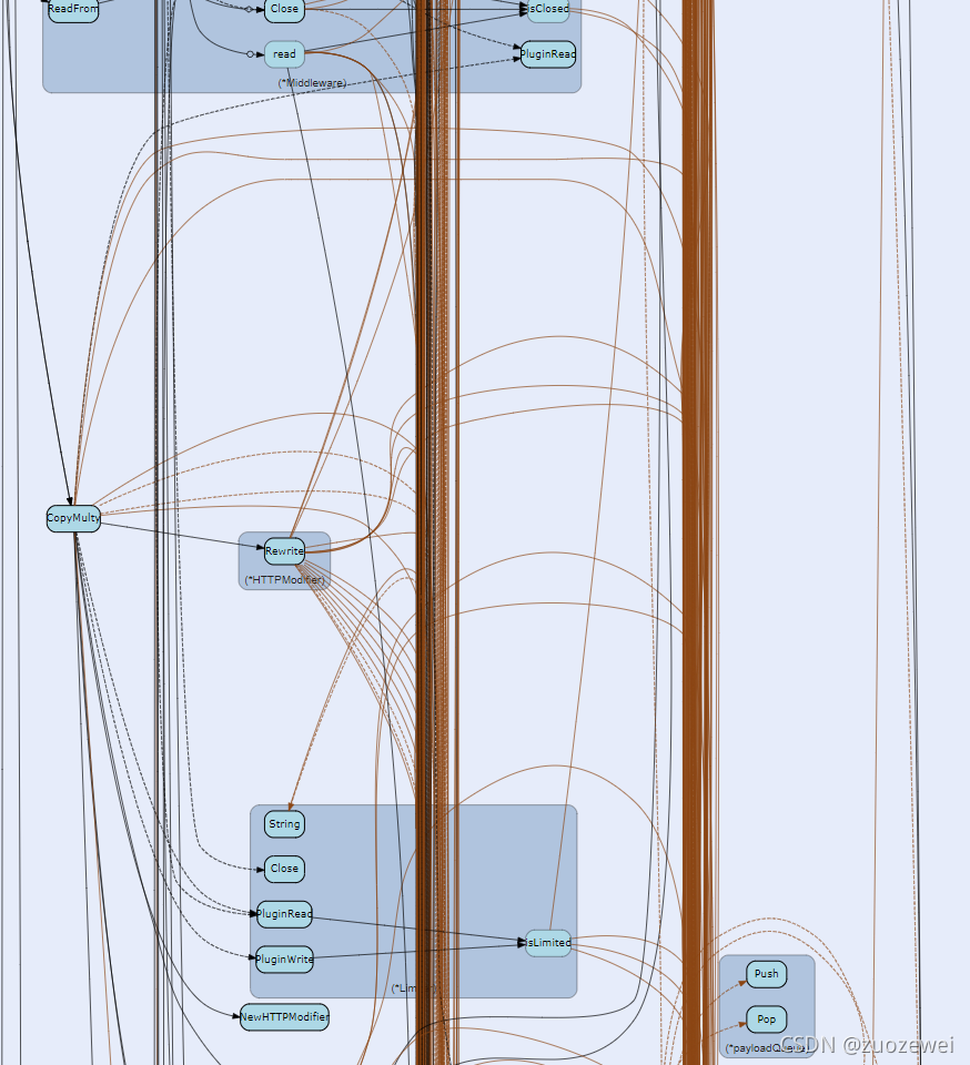

如果只有一个协程,存在性能瓶颈。默认是一个 input 复制多份,写多个 output,如果传了 --split-output 参数,并且有多个 output ,则使用简单的 Round Robin 算法来选 output,不会写多份。多个 input 之间是并行的,但单个 input 到多个 output,是串行的。所有 input 都实现了 io.Reader 接口,output 都实现了 io.Writer 接口。所以阅读代码时,input 的入口是 Read() 方法,output 的入口是 Write() 方法。
// CopyMulty copies from 1 reader to multiple writers
func CopyMulty(src PluginReader, writers ...PluginWriter) error {
	wIndex := 0
	modifier := NewHTTPModifier(&Settings.ModifierConfig)
	filteredRequests := make(map[string]int64)
	filteredRequestsLastCleanTime := time.Now().UnixNano()
	filteredCount := 0
	for {
		msg, err := src.PluginRead()
		if err != nil {
			if err == ErrorStopped || err == io.EOF {
				return nil
			return err
		if msg != nil && len(msg.Data) > 0 {
			if len(msg.Data) > int(Settings.CopyBufferSize) {
				msg.Data = msg.Data[:Settings.CopyBufferSize]
			meta := payloadMeta(msg.Meta)
			if len(meta) < 3 {
				Debug(2, fmt.Sprintf("[EMITTER] Found malformed record %q from %q", msg.Meta, src))
				continue
			requestID := byteutils.SliceToString(meta[1])
			// start a subroutine only when necessary
			if Settings.Verbose >= 3 {
				Debug(3, "[EMITTER] input: ", byteutils.SliceToString(msg.Meta[:len(msg.Meta)-1]), " from: ", src)
			if modifier != nil {
				Debug(3, "[EMITTER] modifier:", requestID, "from:", src)
				if isRequestPayload(msg.Meta) {
					msg.Data = modifier.Rewrite(msg.Data)
					// If modifier tells to skip request
					if len(msg.Data) == 0 {
						filteredRequests[requestID] = time.Now().UnixNano()
						filteredCount++
						continue
					Debug(3, "[EMITTER] Rewritten input:", requestID, "from:", src)
				} else {
					if _, ok := filteredRequests[requestID]; ok {
						delete(filteredRequests, requestID)
						filteredCount--
						continue
			if Settings.PrettifyHTTP {
				msg.Data = prettifyHTTP(msg.Data)
					continue
			if Settings.SplitOutput {
				if Settings.RecognizeTCPSessions {
					if !PRO {
						log.Fatal("Detailed TCP sessions work only with PRO license")
					hasher := fnv.New32a()
					hasher.Write(meta[1])
					wIndex = int(hasher.Sum32()) % len(writers)
					if _, err := writers[wIndex].PluginWrite(msg); err != nil {
						return err
				} else {
					// Simple round robin
						return err
					wIndex = (wIndex + 1) % len(writers)
			} else {
				for _, dst := range writers {
					if _, err := dst.PluginWrite(msg); err != nil && err != io.ErrClosedPipe {
						return err
		// Run GC on each 1000 request
		if filteredCount > 0 && filteredCount%1000 == 0 {
			// Clean up filtered requests for which we didn't get a response to filter
			now := time.Now().UnixNano()
			if now-filteredRequestsLastCleanTime > int64(60*time.Second) {
				for k, v := range filteredRequests {
					if now-v > int64(60*time.Second) {
						delete(filteredRequests, k)
						filteredCount--
				filteredRequestsLastCleanTime = time.Now().UnixNano()

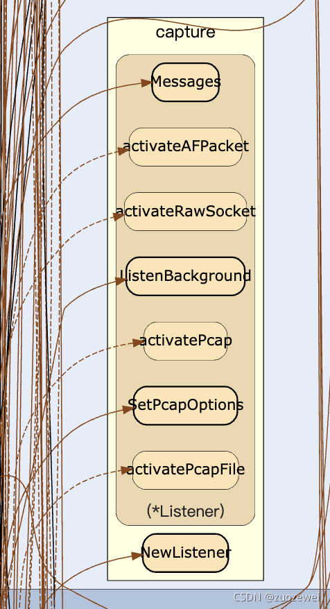

  1. goreplay 抓包调用 google/gopacket 来实现,后者通过 cgo 来调用 libpcap。整体工具小巧而实用,既可以实现 rawsocket 的抓包,也可以实现 http 的录制、回放,也支持多实例之间的级联。RAW_SOCKET 允许监听任何端口上的流量,因为它们是在IP级别上操作的。端口是 TCP 的特性,具有流量控制、传输可靠等优点。这个包实现了自己的TCP层: 使用tcp_packet 解析TCP包。流控制由 tcp_message.go管理
参考地址:http://en.wikipedia.org/wiki/Raw_socket

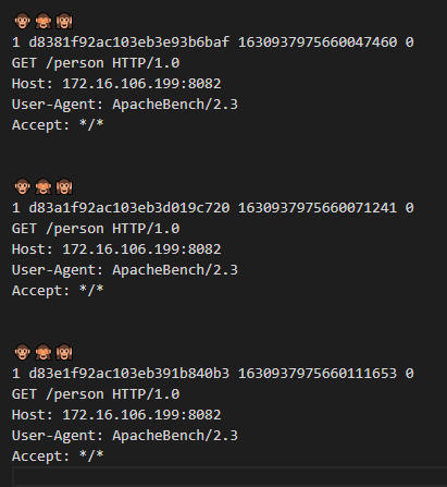

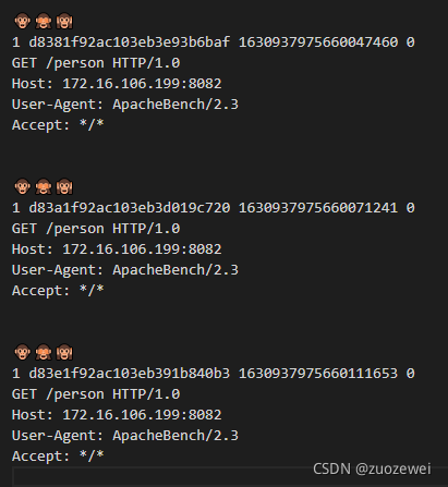

  1. 用三个猴头 🐵🙈🙉 emoji 字符作为请求分隔符,第一眼看到感觉挺搞笑的。
比如:
  1. 配置信息全靠启动命令参数。

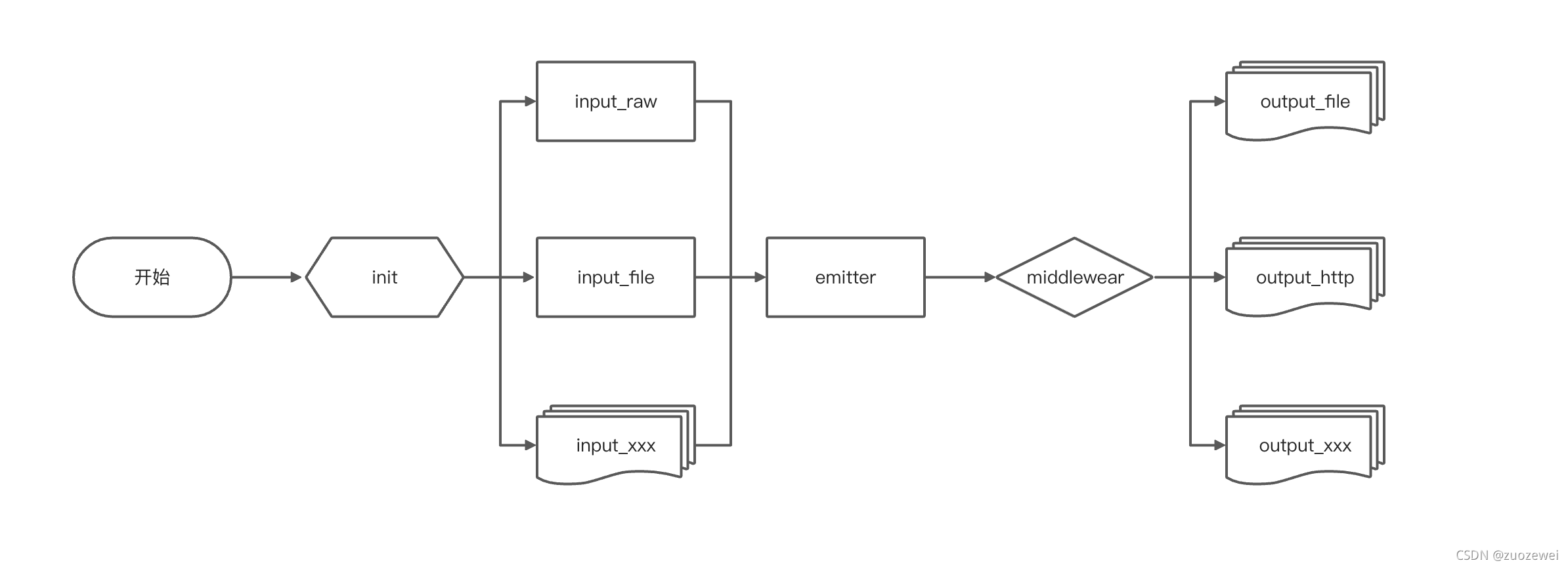

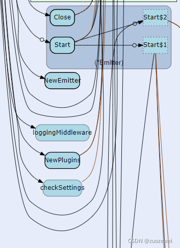

五、代码调用链路图
最后附送一张 gor 代码调用链路图。
原图地址:
