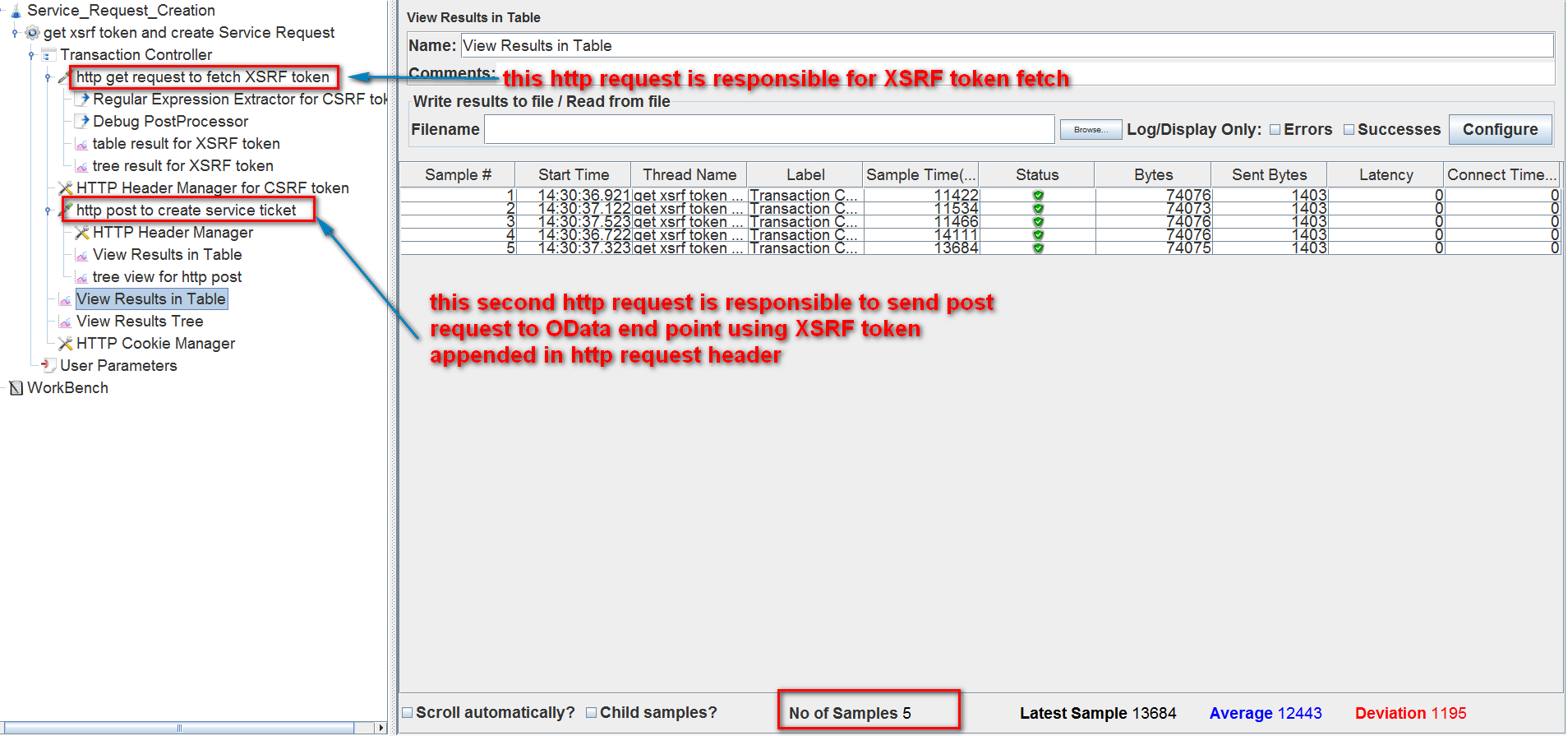

My project in JMeter is displayed with the following hierarchy. I have configured with “Number of 5 threads” in my thread group, so once executed, the response time of these 5 threads are displayed in result table together with average response time.

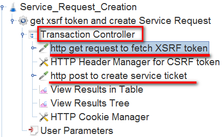

从下图能看出,因为拿CSRF token的HTTP GET在逻辑上必须先于实际需要测试性能的HTTP POST请求,这实际上构成了一个Transaction-事务,所以我使用jMeter里提供的Transaction Controller来管理。
Some key points for this JMeter project creation
(1) Since now one thread should cover both XSRF token fetch via HTTP get and Service request creation via HTTP post, so a transaction controller is necessary to include both request.

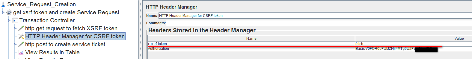

(2) Create the first HTTP request to fetch XSRF token. The setting could be found below: adding a http header field with name as
x-csrf-token and value as “fetch”:
在HTTP GET请求的头部加上一个名为x-csrf-token的字段,值赋成fetch。这样服务器接到这个请求,就知道这是客户端发起的CSRF token请求,于是服务器响应这个请求,把创建好的随机CSRF token通过HTTP response头部字段的方式返回给客户端。

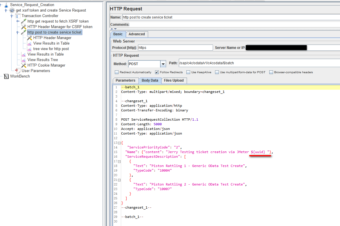

(3) Create another HTTP request with type POST.
这时万事俱备,我们可以开始构造真正要进行性能测试的HTTP post,即Service Ticket的创建请求了。
请求的报文正文:
Just paste the following text to the tab “Body Data”:

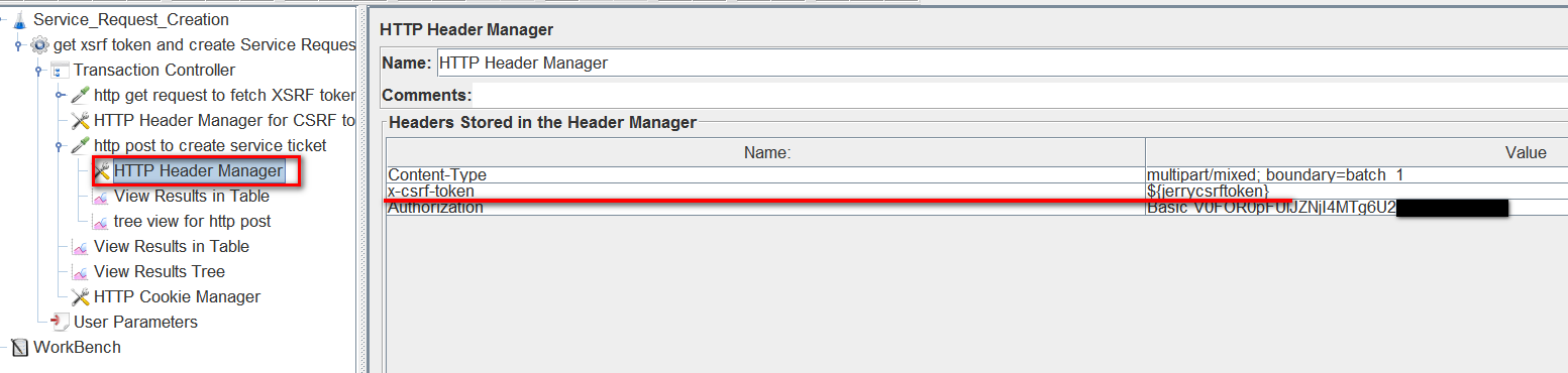

In the body text I use a user-defined variable ${uuid} which we could create it in last step. And for this post request, use the XSRF token fetched from previous HTTP get request.
前面说过,POST请求的头部需要加上合法的CSRF token,此处我们使用前面GET请求已经拿到的并且存储于变量jerrycsrftoken中的token值:

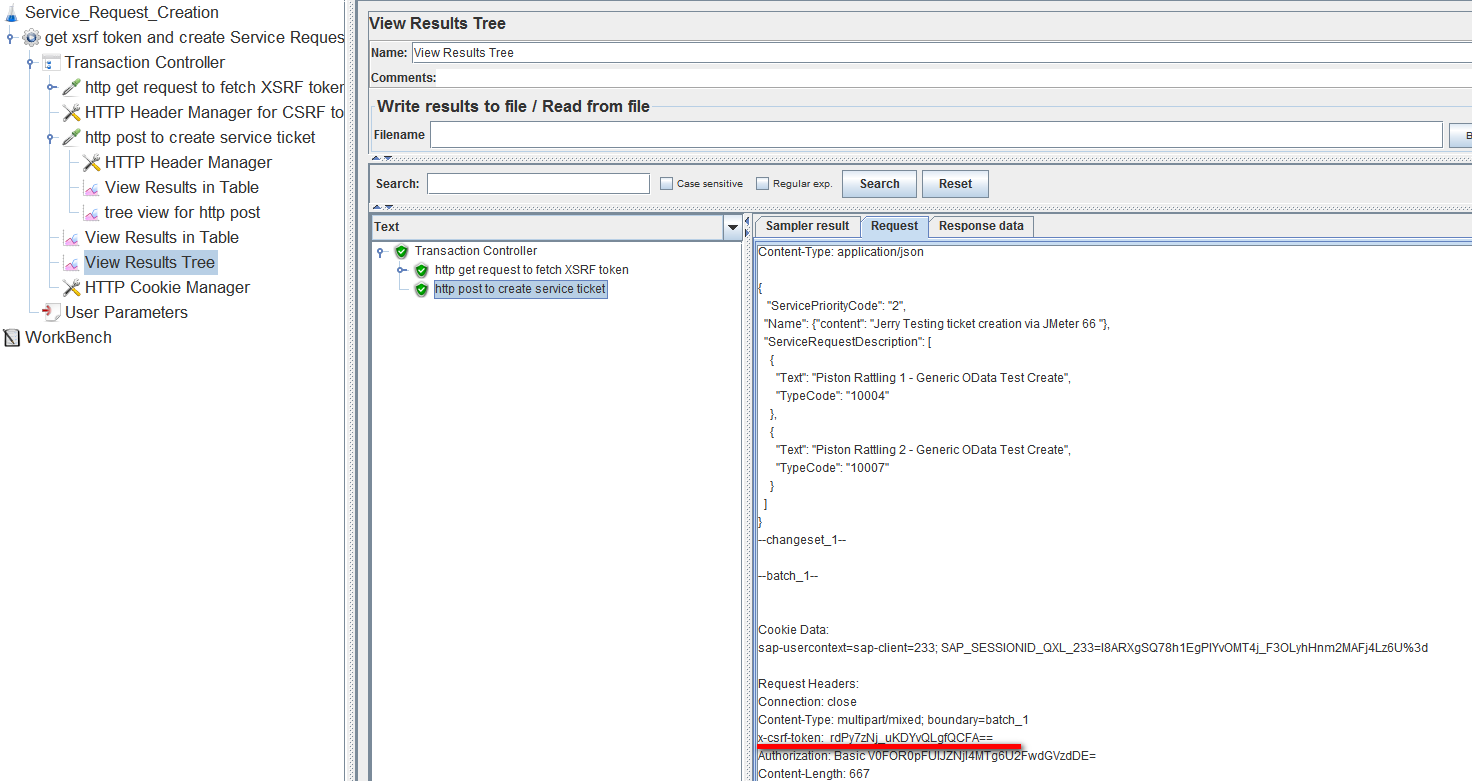

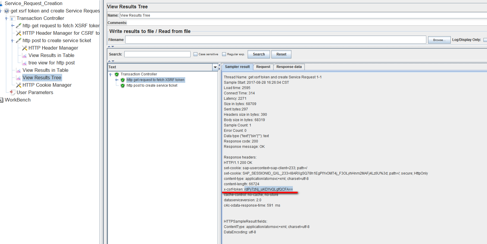

Now execute the Thread group, and the execution detail for these three HTTP request could be reviewed separately in tree view:
试着运行一下,发现这个POST操作确实按照我们期望的那样,在HTTP头部字段里加上了正确合法的CSRF token:
For example, the XSRF token is successfully fetched in the first request: rdPy7zNj_uKDYvQLgfQCFA==
And used as one header field in second HTTP Post request as expected:

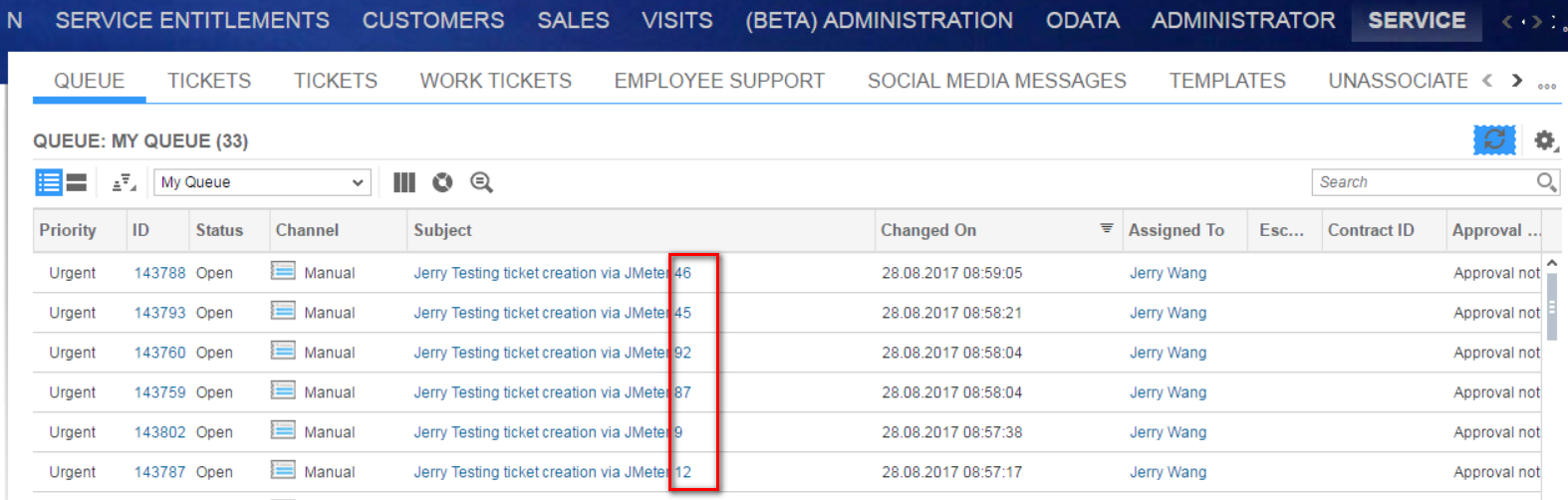

And finally in UI we could find the created Service request with random number between 1 ~ 100 as postfix:
在UI上观测到我构造的5个并发请求创建的Service Ticket,说明CSRF token在服务器端的校验成功,同时发现描述信息都带上了随机数,说明我的jMeter随机数生成器的用法也正确。
