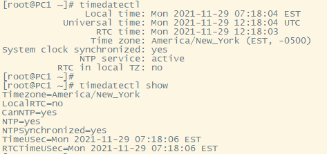

查看系统时间方面的各种状态
  • date
  • timedatectl
  • timedatectl show

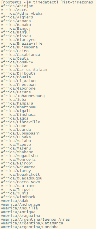

列出所有时区
timedatectl list-timezones

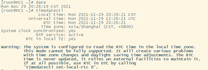

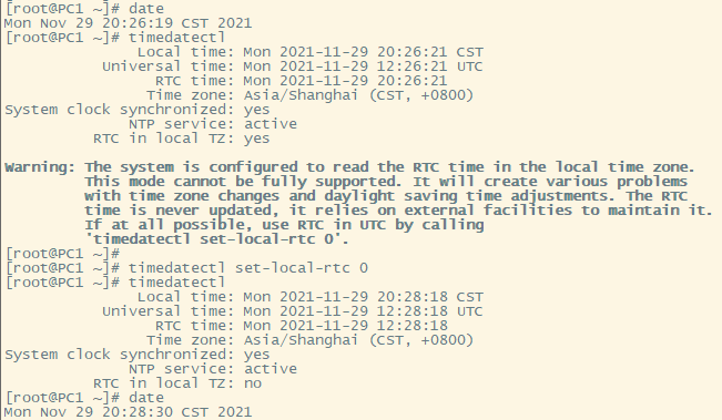

设置硬件时钟时间
  • 设置硬件时钟为本地时间:timedatectl set-local-rtc 1
  • 设置硬件时钟为UTC时间:timedatectl set-local-rtc 0
如果设置为1,会报如下警告。如果仅为了将时间改为本地时间,使用默认的 rtc=1,就行(不用改)
Warning: The system is configured to read the RTC time in the local time zone.
         This mode cannot be fully supported. It will create various problems
         with time zone changes and daylight saving time adjustments. The RTC
         time is never updated, it relies on external facilities to maintain it.
         If at all possible, use RTC in UTC by calling
         'timedatectl set-local-rtc 0'.

设置系统时区为上海
timedatectl set-timezone Asia/Shanghai,修改之后重新打印时间,可以发现已经跟本地时间一样了
