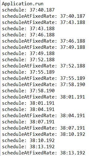

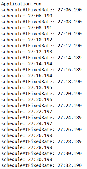

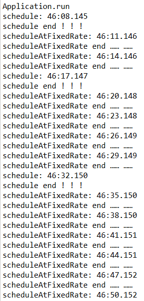

(1)period = 2s,cost = 3s 的情况
(2)period = 2s,cost = 1s 的情况
