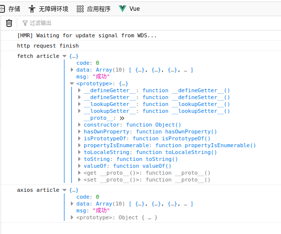

请求方法
在 App.vue 中添加具体请求方法
注意:'err' is declared but its value is never read.
,err已被全局定义,且是只读的,所以必须换个名字
<script>
export default {
mounted: function () {
this.getArticle1()
this.getArticle2()
console.log('http request finish')
methods: {
getArticle1 () {
this.$http.get('/article').then(res => {
console.log('axios article', res.data)
}).catch(_err => {
console.log('axios err', _err)
getTest1 () {
this.$http.get('/test').then(res => {
console.log(res.data)
}).catch(_err => {
getArticle2 () {
this.$fetch.get('./article').then(res => {
console.log('fetch article', res)
}).catch(_err => {
getTest2 () {
this.$fetch.get('./test').then(res => {
console.log('fetch test', res)
}).catch(_err => {
</script>

输出结果
