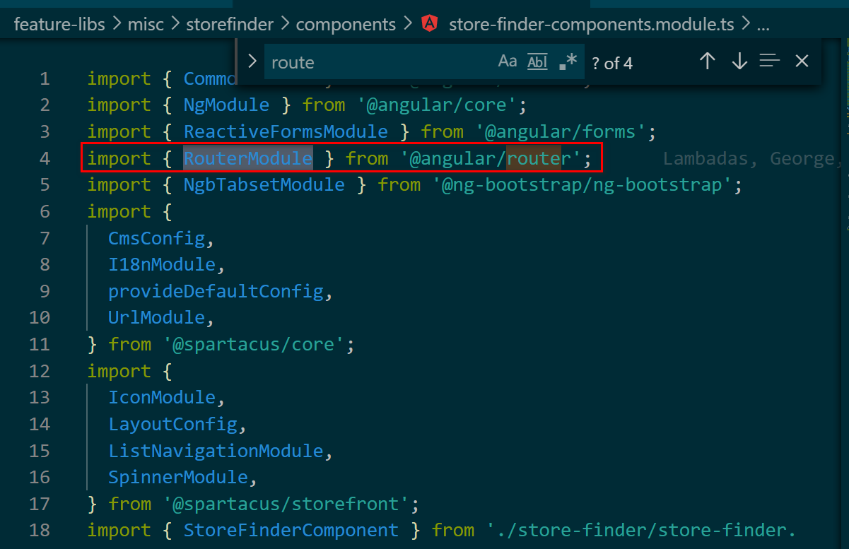

In order to use the Router, you must first register the RouterModule from the @angular/router package.
要使用Angular 路由功能,必须先从@angular/router包里导入RouterModule:

RouterModule provides the Router service, as well as router directives, such as ==RouterOutlet== and routerLink.
RouterModule提供Router服务,Router directive,比如RouterOutlet和RouterLink.
The root application module imports RouterModule so that the application has a Router and the root application components can access the router directives.
Root应用module导入RouterModule,这样应用可以使用Router服务,并且应用Component可以访问router指令。
Any feature modules must also import RouterModule so that their components can place router directives into their templates.
任何feature module都必须导入RouterModule,只有这样,feature module包含的Component才能在其template里使用router指令。

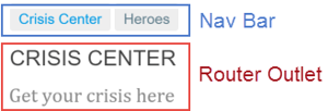

The root AppComponent is the application shell. It has a title, a navigation bar with two links, and a router outlet where the router renders components.
The router outlet serves as a placeholder where the routed components are rendered.
router outlet就是一个占位符,用来存放被路由的Component.
