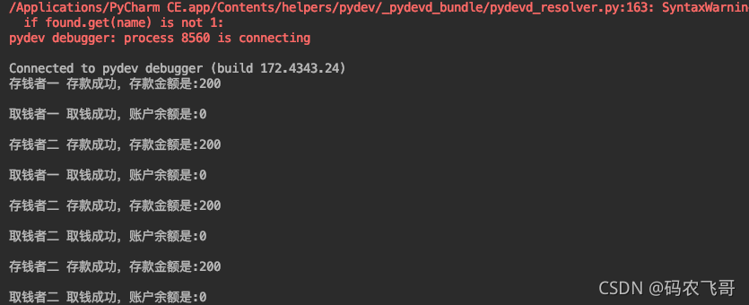

def draw_many(account, draw_amount, max):
    for i in range(max):
        account.draw(draw_amount)
def deposit_many(account, deposit_amount, max):
        account.deposit(deposit_amount)
# 创建一个账户
account = Account("账户一", 0)
# 创建并启动取钱线程
draw_1 = threading.Thread(name='取钱者一', target=draw_many, args=(account, 200, 50))
draw_1.start()
draw_2 = threading.Thread(name='取钱者二', target=draw_many, args=(account, 200, 50))
draw_2.start()
# 创建并启动存钱线程
deposit_1 = threading.Thread(name='存钱者一', target=deposit_many, args=(account, 200, 50))
deposit_1.start()
deposit_2 = threading.Thread(name='存钱者二', target=deposit_many, args=(account, 200, 50))
deposit_2.start()
draw_1.join()
draw_2.join()
deposit_1.join()
deposit_2.join()
运行结果是:
这里关键的控制点是__deposit_flag 标识,用它来标记是否有存款,默认值为False。如果已经存款了则该值为True。如果取款之后则将该值改成False。通过它来控制取款线程和存款线程是进入等待池还是执行业务操作。
