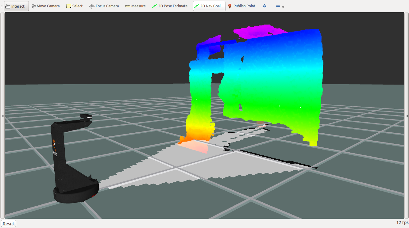

You can visualize the result by running RViz:
$ rosrun rviz rviz
and adding a "PointCloud2" display. Select camera_depth_frame for the Fixed Frame (or whatever frame is appropriate for your sensor) and select output for the PointCloud2 topic. You should see a highly downsampled point cloud. For comparison, you can view the /camera/depth/points topic and see how much it has been downsampled.
