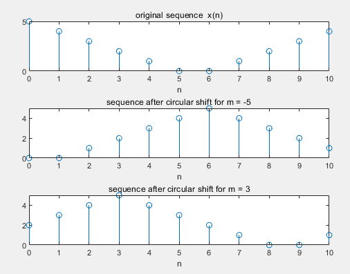

下面给出验证代码:
  1. clc
  2. clear
  3. close all
  4. n = 0:10;
  5. x = [5:-1:0,0:4];
  6. m = -5;
  7. N = 11;
  8. subplot(2,1,1);
  9. stem(n,x);
  10. title('original sequence x(n)');
  11. xlabel('n');
  12. y = cirshftf(x,m,N);
  13. subplot(2,1,2);
  14. stem(n,y);
  15. title('sequence after circular shift for m = -5');
  16. xlabel('n');

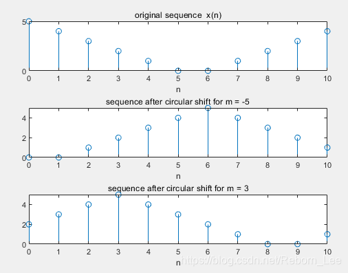

如果m是一个向量的话,假设m = [-5,3],就是对序列x(n),分别循环移位-5和3,得到的y的第一行就是循环移位-5后的序列,而第二行就是循环移位3后的序列:
  1. clc
  2. clear
  3. close all
  4. n = 0:10;
  6. m = [-5,3];
  7. N = 11;
  8. subplot(3,1,1);
  9. stem(n,x);
  11. xlabel('n');
  13. subplot(3,1,2);
  14. stem(n,y(1,:));
  16. xlabel('n');
  17. subplot(3,1,3);
  18. stem(n,y(2,:));
  19. title('sequence after circular shift for m = 3');
  20. xlabel('n');
