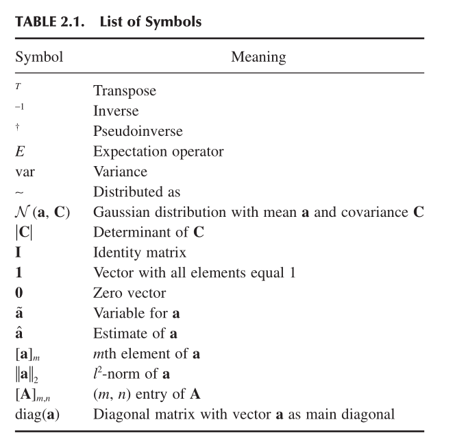

The first category deals with the nonlinear equations directly constructed from the TOA, TDOA, RSS, or DOA measurements, which includes the NLS and ML estimators. On the other hand, the second approach converts the nonlinear equations to be linear, and LLS, WLLS, and subspace methods will be presented. Note that the WLLS estimator is, in fact, a generalized version of the LLS technique, where a weighting function is involved. Section 2.4 contributes to the algorithm analysis, and two important performance measures, namely, mean and variance, will be examined. Furthermore, the computation of CRLB, which is a lower bound on the variance attainable by any unbiased location estimator, will be presented. Finally, concluding remarks are given in Section 2.5 . Symbols that are used in this chapter are listed in Table 2.1 .
第一类涉及直接由TOA,TDOA,RSS或DOA测量构建的非线性方程,其中包括NLS和ML估计。 另一方面,第二种方法将非线性方程转换为线性方程,并且将呈现LLS,WLLS和子空间方法。 注意,WLLS估计器实际上是LLS技术的通用版本,其中涉及加权函数。 第2.4节有助于算法分析,并将检查两个重要的性能指标,即均值和方差。 此外,将呈现CRLB的计算,CRLB是任何无偏位置估计器可获得的方差的下限。 最后,第2.5节给出了结论性意见。 表2.1列出了本章中使用的符号。
