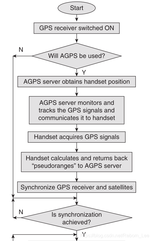

Two pieces of information are required to carry out the localization process via GPS:
1. The distance from the GPS receiver to satellites
2. The position of each satellite in terms of its latitude, longitude, and altitude (see Fig. 1.3 a)
通过GPS执行本地化过程需要两条信息:
1.从GPS接收器到卫星的距离
2.每颗卫星在纬度,经度和海拔高度上的位置(见图1.3a)
The receiver collects these pieces of information and analyzes and processes high - frequency, low - power radio signals received from the satellites.
接收器收集这些信息并分析和处理从卫星接收的高频,低功率无线电信号。
Mathematical details of localization using GPS are discussed in Chapters 22 , 28 , and 29 of this handbook.
流程图放大:
Distance Measurement
Assuming that the clocks of a GPS receiver and a satellite are perfectly synchronized, the distance is measured using TOA estimation.
Specifically, the lag between the signal transmitted by the satellite and the one generated at the GPS receiver is used to determine the distance (see Fig. 1.3 a). Assuming that the satellite begins transmitting a long unique pattern (a pseudorandom code) at midnight and the GPS receiver also starts generating the same pattern at midnight, the lag is determined by comparing the two patterns.

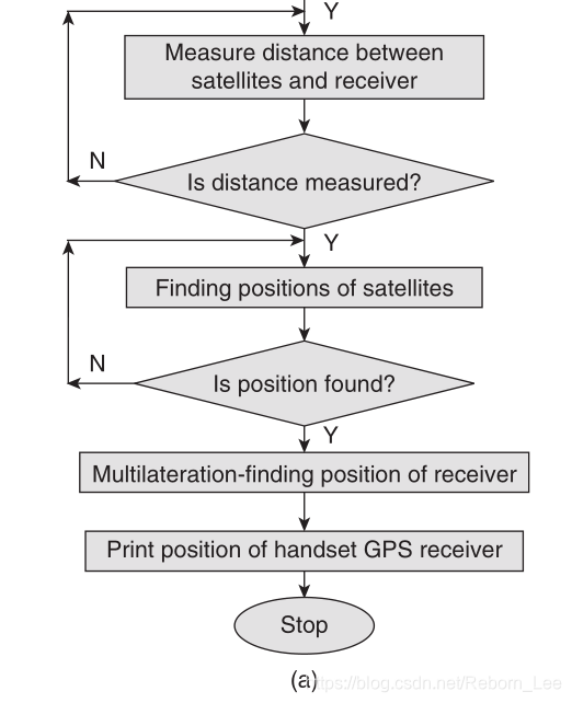

Satellite Positions
This second piece of information is obtainable with little difficulty as the GPS receiver can simply store an almanac that determines the position of every satellite at any given time. The effect of the gravitational pull of the moon and the sun on the satellites ’ orbits is constantly monitored by the U.S.
由于GPS接收器可以简单地存储在任何给定时间确定每个卫星的位置的历书,因此可以毫不费力地获得该第二条信息。 美国不断监测月球和太阳引力对卫星轨道的影响。
Department of Defense, which conveys any adjustments to all GPS receivers as part of the transmitted signals. When the information on the distance from satellites and their positions is known, multilateration (a process similar to triangulation in TOA) is used to fi nd the three - dimensional position of a GPS receiver.
国防部,作为传输信号的一部分,对所有GPS接收机进行任何调整。 当关于距卫星的距离及其位置的信息已知时,使用多点定位(类似于TOA中的三角测量的过程)来找到GPS接收器的三维位置。
