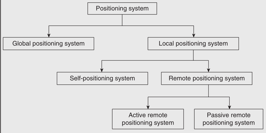

WLPS is a hybrid TOA and DOA positioning method. Based on the classification discussed in Figure 1.1 , it can also be considered as an active remote positioning system.
Figure 1.1

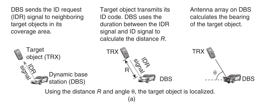

As shown in Figure 1.4 a, the DBS sends the ID request ( IDR ) signal to all active targets in its vicinity. The active targets respond by each transmitting a packet that includes its ID code back to the DBS, which recognizes each target by its unique ID code.
如图1.4a所示,DBS将ID请求(IDR)信号发送到其附近的所有活动目标。 活动目标通过每个将包括其ID码的分组发送回DBS来响应,DBS通过其唯一ID码识别每个目标。
For positioning, the TOA and DOA of the target are estimated by DBS. As described earlier, DOA is estimated using antenna arrays mounted on the DBS. Using these measured values, the positions of active targets can be localized relative to the known position of the DBS.
对于定位,目标的TOA和DOA由DBS估计。 如前所述,使用安装在DBS上的天线阵列估计DOA。 使用这些测量值,可以相对于DBS的已知位置定位活动目标的位置。
