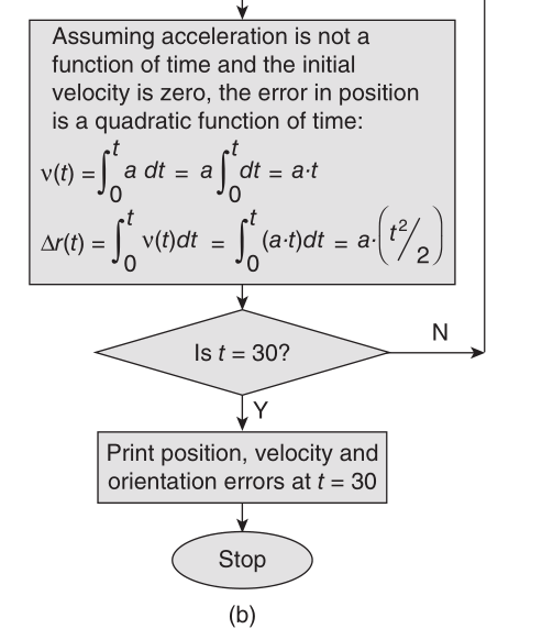

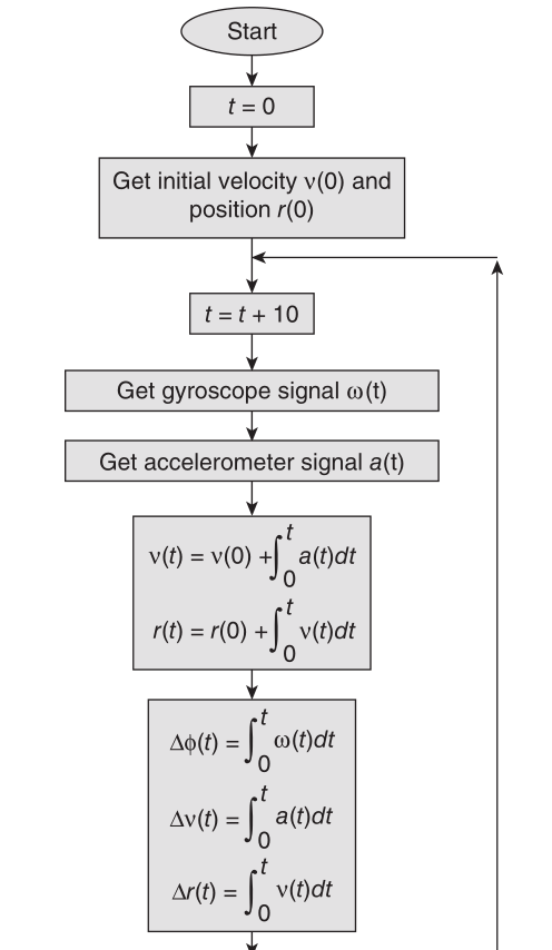

Mathematical integration of the acceleration a ( t ) yields the velocity v ( t ), which, in turn, is integrated to determine the distance traveled from the starting point r ( t ), as shown in Figure 1.3 b.
Figure 1.3 b
Orientation ϕ ( t ) can be found by integrating the angular velocity ω ( t ), also shown in Figure 1.3 b. These calculations are performed periodically to trace the movement of the object with respect to the global reference frame.
 While undertaking the integration for the position of the object, acceleration due to gravity is subtracted from the vertical component of the acceleration.
方位 ϕ ( t ) 可以通过积分角速度 ω(t)找到,也如图1.3b所示。 周期性地执行这些计算以跟踪对象相对于全局参考系的移动。
 在对物体的位置进行积分的同时,从加速度的垂直分量中减去由于重力引起的加速度。
The angular velocity and acceleration measurements made using motion sensors may have errors. When integrating these quantities, the errors in the measured values are propagated to the subsequently calculated position and orientation values. In addition, error is also introduced because the object numerically integrates the measurements at each time step. This error propagation in INS is called integration drift. The localization error can be adjusted to zero by a merger of the INS with other positioning systems such as GPS.
使用运动传感器进行的角速度和加速度测量可能有误差。 当对这些量进行积分时,测量值中的误差将传播到随后计算的位置和方向值。 此外,还引入了误差,因为对象在每个时间步长上数字地集成了测量值。 INS中的这种误差传播称为积分漂移。 通过INS与诸如GPS之类的其他定位系统的合并,可以将定位误差调整为零。
