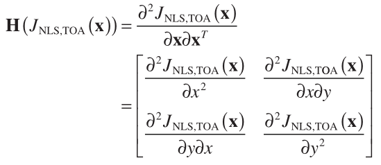

The iterative Newton – Raphson procedure for \bold {\hat{x}} is
                                                                           (5)
where \bold { H(J_{NLS,TOA}(\hat{x}^k)) } and  \bold{ \triangledown (J_{NLS,TOA}(\hat{x}^k) ) } are the corresponding Hessian matrix and gradient vector computed at the k th iteration estimate, namely, \bold { \hat{x} ^ k} , and they have the forms of
                                                                      (6)
with
               (7)
                                          (8)
                                    (9)
