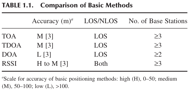

Table 1.1 compares basic positioning methods previously discussed in the chapter in terms of accuracy, a need for the availability of LOS, and the number of base stations required for localization.
表1.1比较了本章前面讨论的基本定位方法的准确性,对LOS可用性的需求以及定位所需的基站数量。
The table shows that on average, the accuracy of the DOA estimate is poorer relative to TOA, TDOA, and RSSI estimates. This is mainly due to the fact that as the distance between the base station and the target increases, a small DOA error leads to a higher localization error. The DOA error is very sensitive to the multipath environment and the signal - to - noise ratio [23] .
该表显示,平均而言,相对于TOA,TDOA和RSSI估计,DOA估计的准确性较差。 这主要是由于随着基站和目标之间的距离增加,小的DOA误差导致更高的定位误差。 DOA误差对多径环境和信噪比非常敏感[23]。
Complex algorithms could be used to improve the DOA performance. DOA performance in localization methods such as WLPS can be improved by incorporating its periodic transmission nature [24, 25] .
复杂算法可用于改善DOA性能。 通过结合其周期性传输特性,可以改善诸如WLPS的定位方法中的DOA性能[24,25]。
RSSI is different from other methods when the availability of LOS is taken into account, since it operates in both LOS and NLOS environments. Other localization techniques are very sensitive to the availability of LOS.
当考虑LOS的可用性时,RSSI与其他方法不同,因为它在LOS和NLOS环境中都运行。 其他定位技术对LOS的可用性非常敏感。

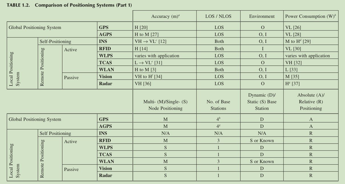

Table 1.2 compares different positioning systems based on several parameters.
The following observations can be made from the table:
• Most of the systems that operate based on the availability of LOS propagation have higher accuracy. Thus, NLOS introduces error in the calculation, decreasing the accuracy.
• Many existing positioning systems employ multiple base nodes to localize the target node. This may create a system cost problem for the designer.
• The power consumption for most positioning systems is medium to very low. Thus, using one of the low - power positioning systems does not impose additional constraint on the designer with respect to the required power consumption.
• All positioning systems except RFID - based systems can support mobility.
• Many positioning systems are well suited for both outdoor and indoor environments.

a:
Scale for accuracy of positioning systems: very high (VH), < 1; high (H), 1 – 5; medium (M), 5 – 30; low (L), 30 – 50; very low (VL), > 50.
定位系统精度的标度:非常高(VH),<1; 高(H),1 - 5; 中(M),5 - 30; 低(L),30 - 50; 非常低(VL),> 50。
b:
 Scale for power consumption of positioning systems: very low (VL), < 1; low (L), 1 – 10; moderate (M), 10 – 50; high(H), 50 – 200; very high (VH), > 200.
定位系统功耗的标度:非常低(VL),<1; 低(L),1 - 10; 中度(M),10 - 50; 高(H),50 - 200; 非常高(VH),> 200。
c:
The initial accuracy is high (few decimeters), which changes with time due to error propagation.
初始精度很高(几个分米),由于误差传播而随时间变化。
d:
Depends on INS classification (stable platform system consumes high power; strapdown system consumes moderate power).
取决于INS分类(稳定平台系统消耗高功率;捷联系统消耗中等功率)。
e:
The initial accuracy is low (few degrees), which decreases with distance.
初始精度很低(几度),随着距离的增加而减小。
f:
The detection range of the vision system is 1 – 95 m, which determines the accuracy.
视觉系统的检测范围是1-95米,这决定了准确性。
g:
Within the high range, the power consumption depends on the peak power output.
在高范围内,功耗取决于峰值功率输出。
h:
 In GPS and AGPS, satellites are considered as base stations.
在GPS和AGPS中,卫星被视为基站。
O, outdoor; I, indoor; N/A, not applicable.
