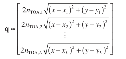

 is now transformed to b , A is constructed from the known receiver positions, and θ contains the source location to be determined. When \{ m_{TOA,l}\} are sufficiently small such that
\bold{r}_{TOA} 现在转换为 b,由已知的接收器位置构成,θ 包含要确定的源位置。当  \{ m_{TOA,l}\} 足够小
                                        (12)
can be considered a zero - mean vector; that is, E { q } ≈ 0 , we can approximate Equation (11)as
                                                                                                                   (13)

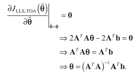

The LLS estimate corresponds to
                                                                           (15)
which can be easily computed by differentiating Equation (14) with respect to  \bold{ \tilde \theta } and by setting the resultant expression to zero:
                                            (16)
The LLS position estimate is simply extracted from the fi rst and second entries of \bold{ \tilde \theta }; that is,
                                                                                                (17)
