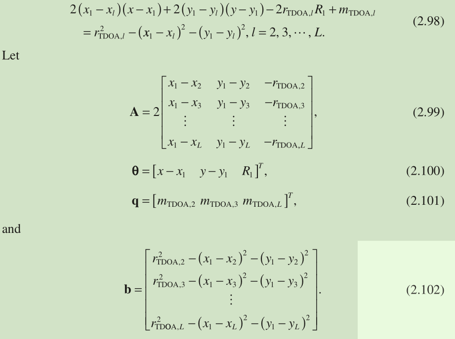

In a similar manner, we first rewrite Equation 2.13 with the use of Equation 2.14 as
Let
be the modified noise component and introduce a dummy variable R 1 of the form
Squaring both sides of Equation 2.95 and employing Equations 2.96 and 2.97 , we get
The matrix form for Equation 2.98 is then identical to Equation 2.82 and the LLS estimate of θ is also given as Equation 2.87 , provided that the noises in q are sufficiently small such that n^2_{TDOA,l} can be ignored. Note that in order to solve Equation 2.98 in a unique manner, the minimum number of receivers is now L = 4 because of the introduction of the additional variable of R 1 . Finally, the LLS posi tion estimate is obtained from the first and second entries of \bold {\hat \theta}; that is,

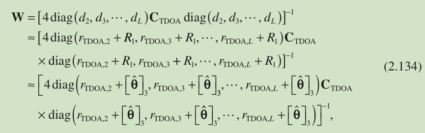

Similarly, the WLLS version for Equation 2.95 is also computed using Equation 2.122 , where the weighting matrix is now
while A , θ , and b are defined as in Equations 2.99 , 2.100 , and 2.102 , respectively. As the estimate of R 1 is not available at the beginning, we first use the LLS estimator to obtain [\hat \theta]_3. The WLLS position estimate is given by Equation 2.103 . The two - step WLS estimator for TDOA - based positioning can be derived by following Equations 2.123 – 2.133 [20] .
