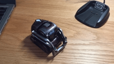

Cozmo环顾四周,找寻充电底座图标,然后行驶到附近,任务完成。

 8. drive to charger
让Cozmo行驶到充电底座附近。
      import asyncio
      import time
      import cozmo
      from cozmo.util import degrees, distance_mm, speed_mmps
      def drive_to_charger(robot):
      '''The core of the drive_to_charger program'''
      # If the robot was on the charger, drive them forward and clear of the charger
      if robot.is_on_charger:
      # drive off the charger
       robot.drive_off_charger_contacts().wait_for_completed()
       robot.drive_straight(distance_mm(100), speed_mmps(50)).wait_for_completed()
      # Start moving the lift down
       robot.move_lift(-3)
      # turn around to look at the charger
       robot.turn_in_place(degrees(180)).wait_for_completed()
      # Tilt the head to be level
       robot.set_head_angle(degrees(0)).wait_for_completed()
      # wait half a second to ensure Cozmo has seen the charger
       time.sleep(0.5)
      # drive backwards away from the charger
       robot.drive_straight(distance_mm(-60), speed_mmps(50)).wait_for_completed()
      # try to find the charger
       charger = None
      # see if Cozmo already knows where the charger is
      if robot.world.charger:
      if robot.world.charger.pose.is_comparable(robot.pose):
       print("Cozmo already knows where the charger is!")
       charger = robot.world.charger
      else:
      # Cozmo knows about the charger, but the pose is not based on the
      # same origin as the robot (e.g. the robot was moved since seeing
      # the charger) so try to look for the charger first
      pass
      if not charger:
      # Tell Cozmo to look around for the charger
       look_around = robot.start_behavior(cozmo.behavior.BehaviorTypes.LookAroundInPlace)
      try:
       charger = robot.world.wait_for_observed_charger(timeout=30)
       print("Found charger: %s" % charger)
      except asyncio.TimeoutError:
       print("Didn't see the charger")
      finally:
      # whether we find it or not, we want to stop the behavior
       look_around.stop()
      if charger:
      # Attempt to drive near to the charger, and then stop.
       action = robot.go_to_object(charger, distance_mm(65.0))
       action.wait_for_completed()
       print("Completed action: result = %s" % action)
       print("Done.")
      cozmo.robot.Robot.drive_off_charger_on_connect = False  # Cozmo can stay on charger for now
      cozmo.run_program(drive_to_charger, use_viewer=True, force_viewer_on_top=True)
