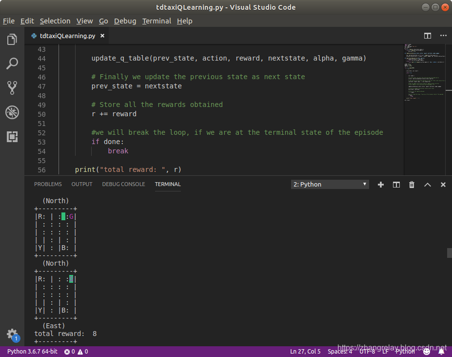

出租车案例-Q学习
  1. import random
  2. import gym
  3. env = gym.make('Taxi-v2')
  4. env.render()
  5. q = {}
  6. for s in range(env.observation_space.n):
  7. for a in range(env.action_space.n):
  8. q[(s,a)] = 0.0
  9. def update_q_table(prev_state, action, reward, nextstate, alpha, gamma):
  10. qa = max([q[(nextstate, a)] for a in range(env.action_space.n)])
  11. q[(prev_state,action)] += alpha * (reward + gamma * qa - q[(prev_state,action)])
  12. def epsilon_greedy_policy(state, epsilon):
  13. if random.uniform(0,1) < epsilon:
  14. return env.action_space.sample()
  15. else:
  16. return max(list(range(env.action_space.n)), key = lambda x: q[(state,x)])
  17. alpha = 0.4
  18. gamma = 0.999
  19. epsilon = 0.017
  20. for i in range(8000):
  21. r = 0
  22. prev_state = env.reset()
  23. while True:
  24. env.render()
  25. # In each state, we select the action by epsilon-greedy policy
  26. action = epsilon_greedy_policy(prev_state, epsilon)
  27. # then we perform the action and move to the next state, and receive the reward
  28. nextstate, reward, done, _ = env.step(action)
  29. # Next we update the Q value using our update_q_table function
  30. # which updates the Q value by Q learning update rule
  31. update_q_table(prev_state, action, reward, nextstate, alpha, gamma)
  32. # Finally we update the previous state as next state
  33. prev_state = nextstate
  34. # Store all the rewards obtained
  35. r += reward
  36. #we will break the loop, if we are at the terminal state of the episode
  37. if done:
  38. break
  39. print("total reward: ", r)
  40. env.close()
部分结果如下:
  1. +---------+
  2. |R: | : :G|
  3. | : : : : |
  4. | : : : : |
  5. | | : | : |
  6. |Y| : |B: |
  7. +---------+
  8. +---------+
  9. |R: | : :G|
  10. | : : : : |
  11. | : : : : |
  12. | | : | : |
  13. |Y| : |B: |
  14. +---------+
  15. (East)
  16. +---------+
  17. |R: | : :G|
  18. | : : : : |
  19. | : : : : |
  20. | | : | : |
  21. |Y| : |B: |
  22. +---------+
  23. (South)
  24. +---------+
  25. |R: | : :G|
  26. | : : : : |
  27. | : : : : |
  28. | | : | : |
  29. |Y| : |B: |
  30. +---------+
  31. (South)
  32. +---------+
  33. |R: | : :G|
  34. | : : : : |
  35. | : : : : |
  36. | | : | : |
  37. |Y| : |B: |
  38. +---------+
  39. (South)
  40. +---------+
  41. |R: | : :G|
  42. | : : : : |
  43. | : : : : |
  44. | | : | : |
  45. |Y| : |B: |
  46. +---------+
  47. (South)
  48. +---------+
  49. |R: | : :G|
  50. | : : : : |
  51. | : : : : |
  52. | | : | : |
  53. |Y| : |B: |
  54. +---------+
  55. (Pickup)
  56. +---------+
  57. |R: | : :G|
  58. | : : : : |
  59. | : : : : |
  60. | | : |_: |
  61. |Y| : |B: |
  62. +---------+
  63. (North)
  64. +---------+
  65. |R: | : :G|
  66. | : : : : |
  67. | : : :_: |
  68. | | : | : |
  69. |Y| : |B: |
  70. +---------+
  71. (North)
  72. +---------+
  73. |R: | : :G|
  74. | : : : : |
  75. | : :_: : |
  76. | | : | : |
  77. |Y| : |B: |
  78. +---------+
  79. (West)
  80. +---------+
  81. |R: | : :G|
  82. | : :_: : |
  83. | : : : : |
  84. | | : | : |
  85. |Y| : |B: |
  86. +---------+
  87. (North)
  88. +---------+
  89. |R: | : :G|
  90. | :_: : : |
  91. | : : : : |
  92. | | : | : |
  93. |Y| : |B: |
  94. +---------+
  95. (West)
  96. +---------+
  97. |R:_| : :G|
  98. | : : : : |
  99. | : : : : |
  100. | | : | : |
  101. |Y| : |B: |
  102. +---------+
  103. (North)
  104. +---------+
  105. |R: | : :G|
  106. | : : : : |
  107. | : : : : |
  108. | | : | : |
  109. |Y| : |B: |
  110. +---------+
  111. (West)
  112. total reward: 7

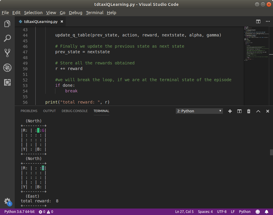

出租车案例-SARSA
  1. import random
  2. import gym
  4. env.render()
  5. Q = {}
  8. Q[(s,a)] = 0.0
  9. def epsilon_greedy(state, epsilon):
  10. if random.uniform(0,1) < epsilon:
  11. return env.action_space.sample()
  12. else:
  13. return max(list(range(env.action_space.n)), key = lambda x: Q[(state,x)])
  14. alpha = 0.85
  15. gamma = 0.90
  16. epsilon = 0.8
  17. for i in range(4000):
  18. # we store cumulative reward of each episodes in r
  19. r = 0
  20. # initialize the state,
  21. state = env.reset()
  22. # select the action using epsilon-greedy policy
  23. action = epsilon_greedy(state,epsilon)
  24. while True:
  25. # env.render()
  26. env.render()
  29. # again, we select the next action using epsilon greedy policy
  30. nextaction = epsilon_greedy(nextstate,epsilon)
  31. # we calculate the Q value of previous state using our update rule
  32. Q[(state,action)] += alpha * (reward + gamma * Q[(nextstate,nextaction)]-Q[(state,action)])
  33. # finally we update our state and action with next action and next state
  34. action = nextaction
  35. state = nextstate
  36. # store the rewards
  37. r += reward
  38. # we will break the loop, if we are at the terminal state of the episode
  39. if done:
  40. break
  41. print("total reward: ", r)
  42. env.close()
 部分结果显示如下:
  1. +---------+
  2. |R: | : :G|
  3. | : : : : |
  4. | : : : : |
  5. | | : | : |
  6. |Y| : |B: |
  7. +---------+
  8. (Pickup)
